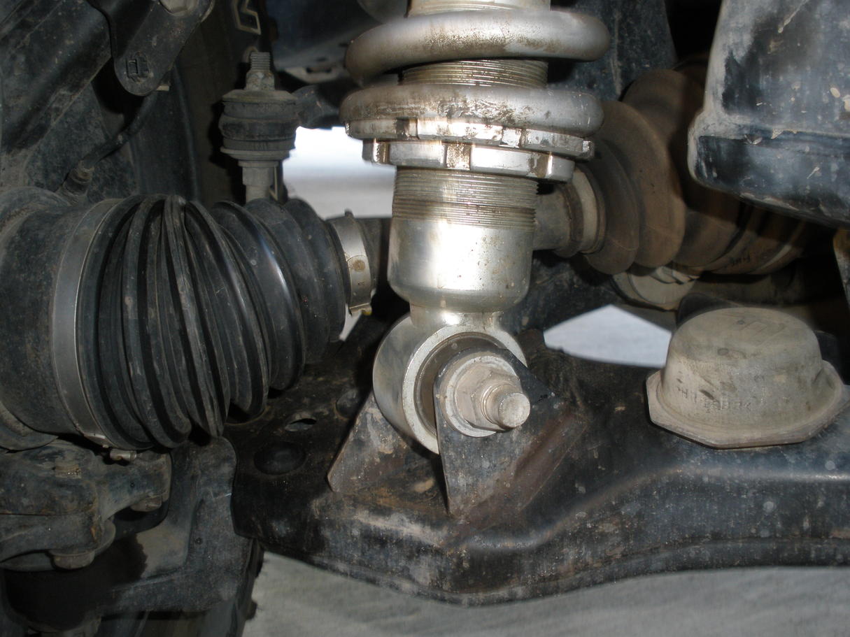

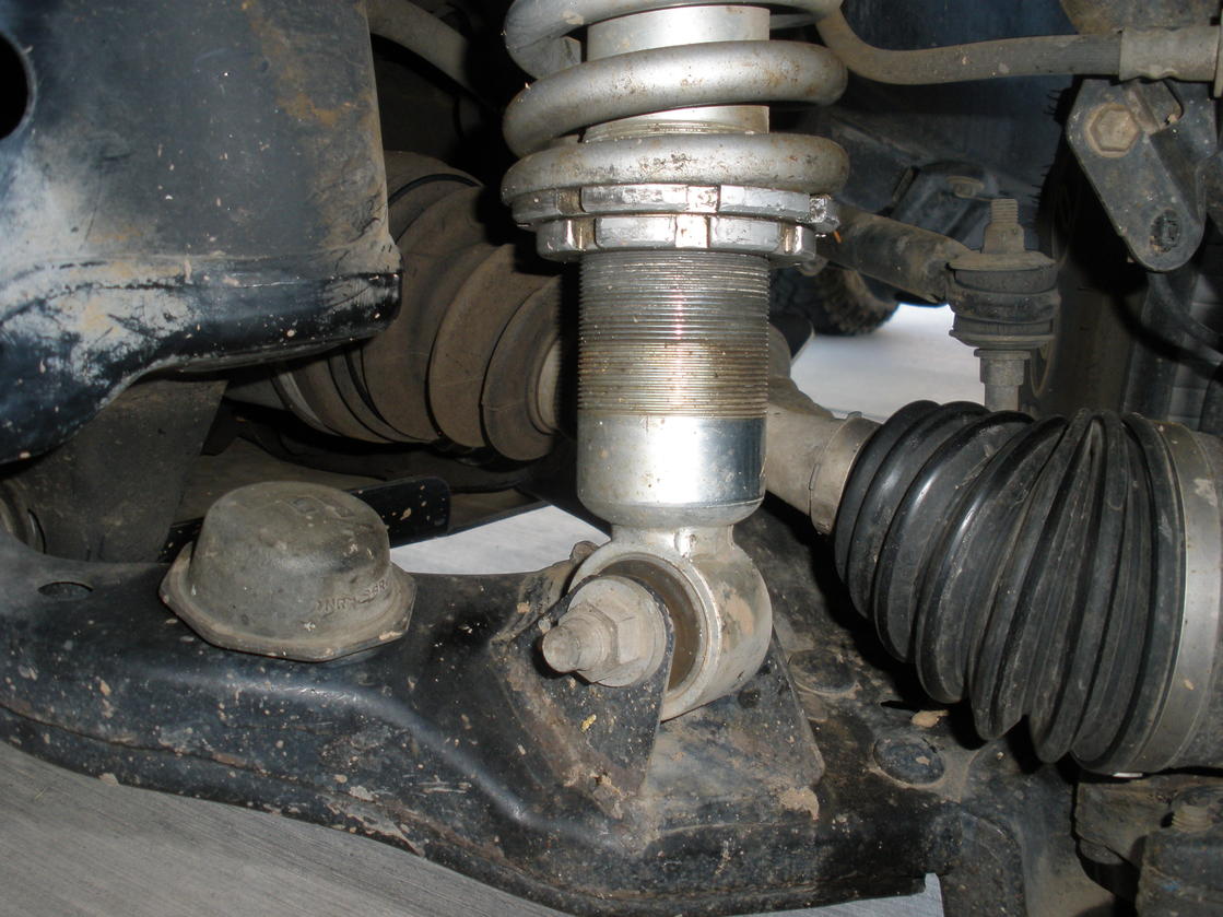

I adjusted my coilover for all the weight I've added. Check my pics, one side's showing 2" more thread, that's what it took to get the left and right level, that normal?

Looks like mine...I had to crank up the driver's side quite a bit more than the passenger's side. I have the 600 lb. coils and an ARB front bumper.

No I have them both set at the same height. However my passenger side does sit higher than the driver side. It's not enough that I'm worried about it though. Every truck is different, so I don't think that it is a problem that you have one side cranked higher than the other.

It looks to me like you have way more than 3 inches of lift here. I would try lowering it down quite a bit and see if the difference between the two side evens out
One other possibility is that the coilover is just fully extended and you are not getting any lift by cranking them up that high.
