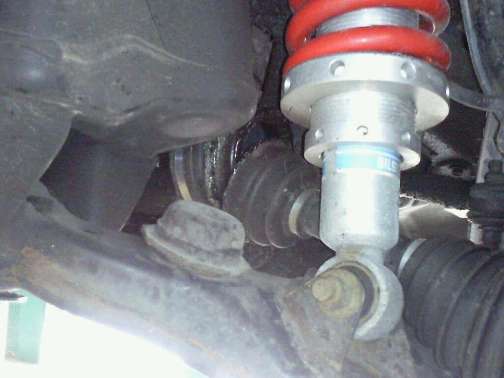

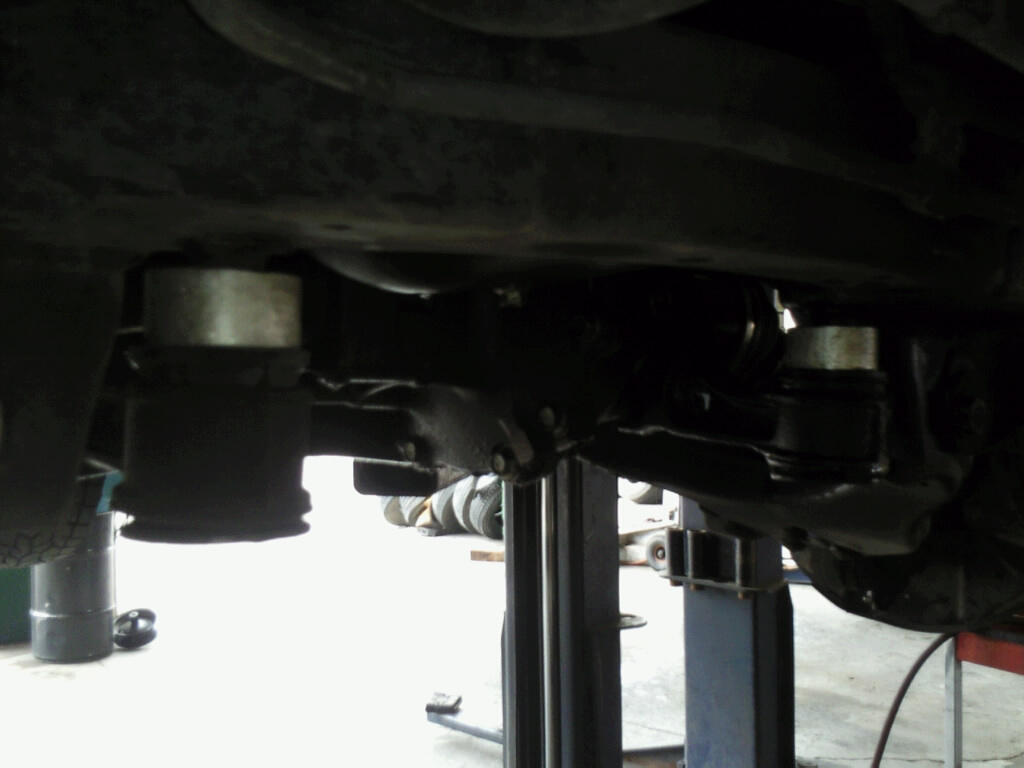

Sorry all have had a very busy weekend, weddings, proms and work. Ok I have installed the 3" ultimate with diff drop I don't remember the spring numbers but I have adjustable front shocks I didn't change them or anything when installed I do know that they were a real B@$%h to put on. That was my main reason for calling Toytec to make sure I even got the right ones (not saying that they sent me wrong stuff just checking, It happens) so I am at a loss. Above pic's are left side before replacing boot and going down on the shock while up on a rack and the other one is of the diff drop installed.

Wow... 5 cv boots with that setting on the coilover? you should be fine...
What boots are you using? they have to be crap. I cannot think of another explanation. I would go after the maker of the boot... I cant imagine those being a problem.
