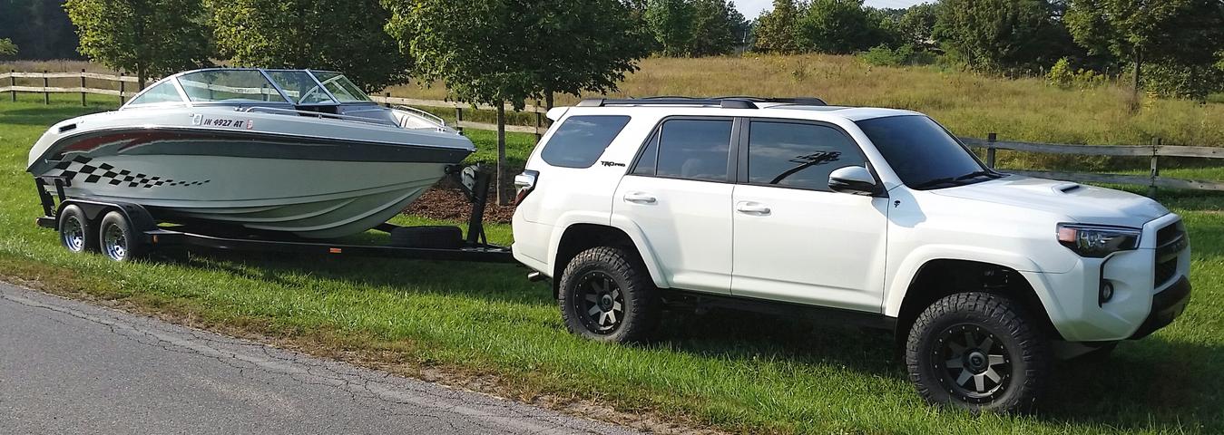

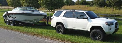

Hi, I installed a Toytec body lift a month ago. Install was really easy and I did this myself in a few hours in my garage. The reason for me wanting to do this was. My bilstein setup is 6112/ 5160 set at 2 in. I added a Toytec 1/2 in top spacer when doing the body lift also. I could have easily have just moved 6112 up to the top notch for a full 3 in lift. Reason for more lift was for 285/70/17 in Nitto Grappler tires. My current set up before body lift was already providing me a great ride. I didn't want to compromise my ride thus the body lift and spacer. Also added 3/4 in Cornfed to rear. I had N-Fab steps on it but they mounted to the body so no difference in look. I sold those and now waiting for my Shrockworks sliders that mount to frame. They are going to adjust mine for the body lift. Only pic I have right now.

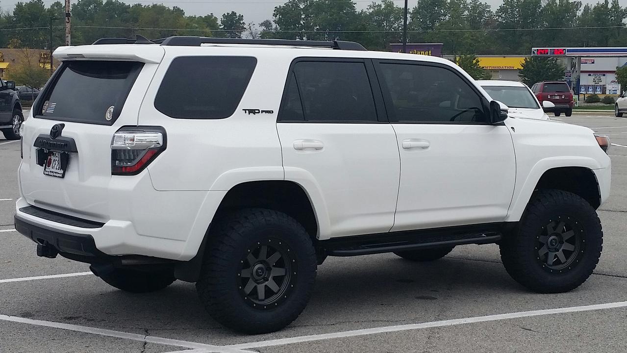

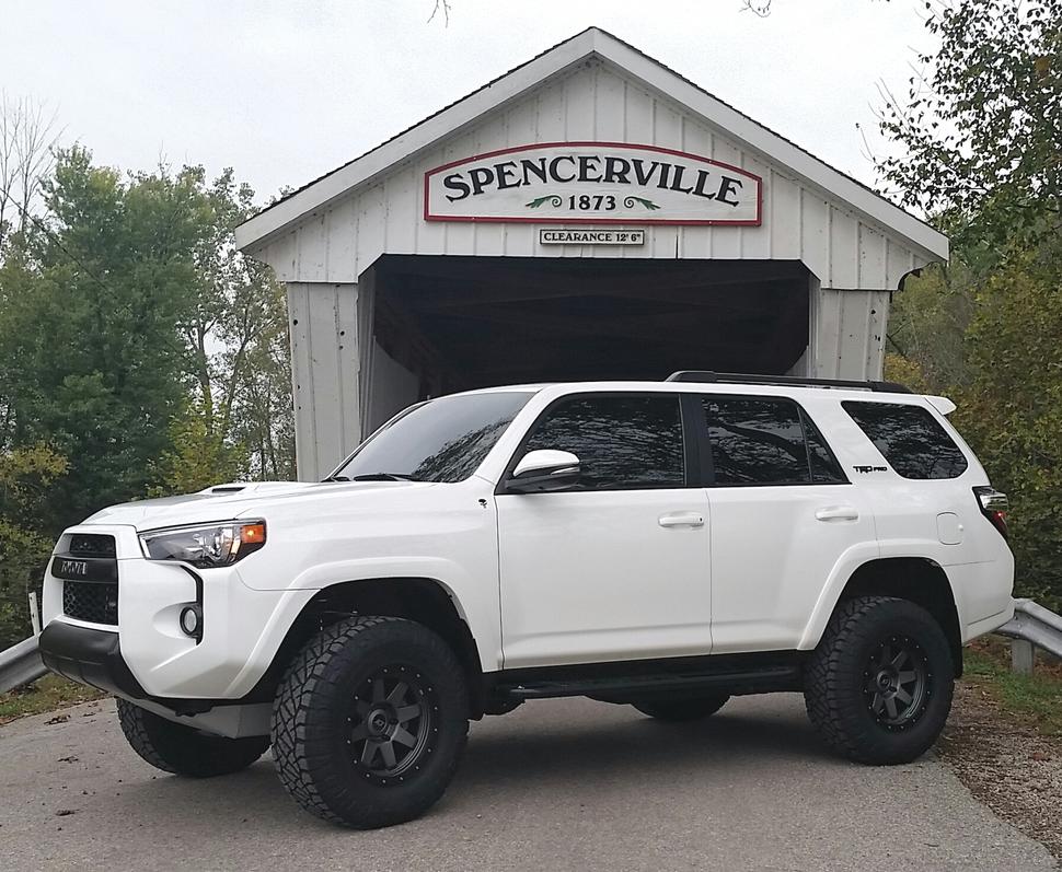

Here you go. They did a awesome job.
from that far it looks good, what does the gap look like up close? could it be any closer to the body?
It is as close as it can be. Im not one for things not being as correct as possible. Just order yours and tell them what you want and enjoy. They know what they are doing.
