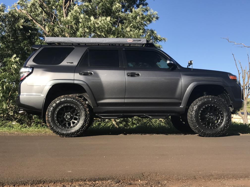

Bilstein/ Toytec 3" and Toytec 1" Bodylift:
Looks great!
Did you run into any problems? Any feedback/suggestions/etc for those of us who are curious?
Nope No Problems , im running NFAB steps and if you look close to my pic, Gap between the rocker panel and NFABs look normal as when i didnt have the bodylift, The Install was done by one of Hawaiis Top Lift shop (Maui Offroad) they did a very good job and it took about 4 hours.Ride still feels awesome!
