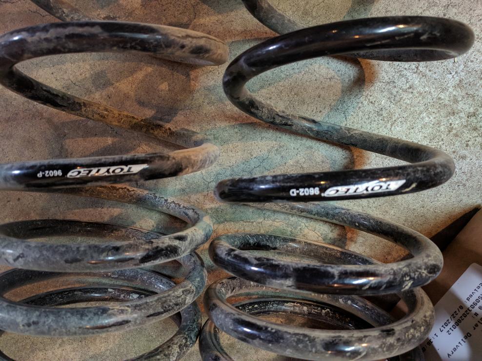

I didn't take any photos, but you can see some of it on the tight coils here.

Yep, my Toytec Superflex coils have been quiet for all 4 years I've had them on. They came with the rubber on the tight coils like the picture above. They haven't sagged over the 4 years either, still at the same height as when new.
