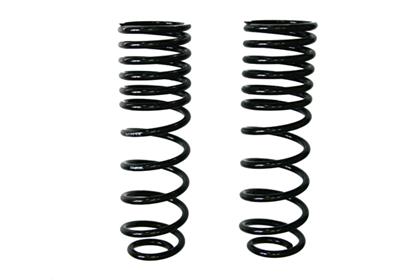

Although theyve been out for 4 or 5 years now, we've been getting a lot of calls about the Toytec Superflex rear coils lately. We decided to put up a thread here with the info weve collected and hopefully some of you that own them can chime in with reviews and pictures to help the other members here.
ToyTec Superflex Rear Coil Spring (1996-02 4Runner)
Part Number - 024RCB
Spring Rate - 240#
Compared to ARB / OME Springs, they are between the OME 2891 & OME 2861. These springs when loaded with 200# of weight will ride 2" higher than OME 2891.
Toytec Description
ToyTec Superflex Rear Lift coil springs offer a great ride quality and increased rear flex off-road while providing extra carrying capacity.
These coils are custom made to our high quality of standards. Come side specific to avoid typical driver side lean that most 3rd Gen 4Runner’s have.
With 10 coil winds these rear coils will handle more load without sagging and still maintain a great ride!
3.75”+ rear lift with stock rear weight. (Weve seen 4"+)
3.25” rear lift with 200lbs over stock rear weight.
3” rear lift with 400lbs over stock rear weight.

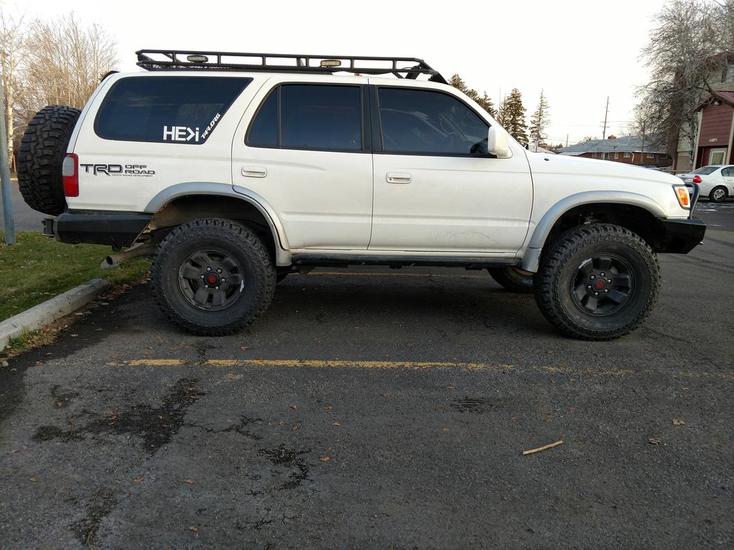

Here is mine on Superflex-
For reference, the front is 3", and the tires are 315/70R17.
I like the ride, and handles the weight I carry fine, but I also wish they were shorter. Maybe the 3" would have been a better coil for me.
They have a 3" coil, and a Superflex coil(3.75" lift) for the 3rd gen. Only one is the Superflex though.

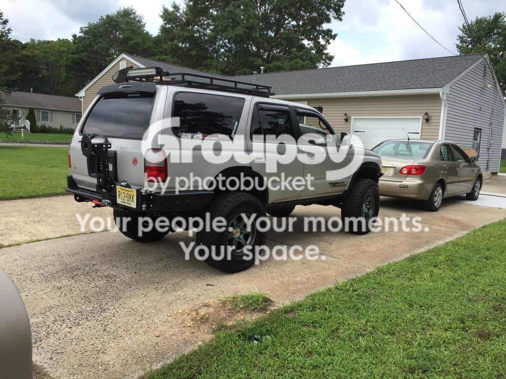

I have the superflex rears. I really like how they ride and I have a custom bandit bumper with custom swing out with a 33" MT and two military Jerry cans with sub in the back. Not sure the exact weight but it's really nice. Front set to about 3" lift and rear is just about there or just a hair higher but I forget the exact measurements. I am worried about when I put my drawers in the back and everything that it is going to be saggy.
