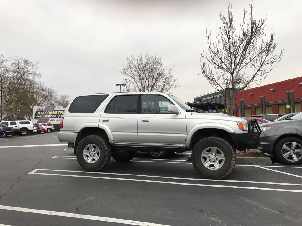

In terms of ride quality they are great, not too stiff as some people have reported; But for my needs I do find them a little short.
I am running Toytec Eibach coils up front on Tundra 5100's on the lowest setting (per toytec's recommendation) up front I have an ARB bumper and I would say I have maybe 2.5in of lift (not scientific)
The 890's sit just about level with the front and I believe I netted 2.5in all the way around. I am running 285/75/16 KO2's and I need a little more lift for proper clearance then I currently have.
I like having some rake on the 3rd Gen, so I wish I had gone with the SuperFlex, according to Toytec the 890 and the 3" superflex are exactly the same :confused::noidea: But I think they are probably a little taller in reality

My gut is telling me as well that the Toytec 3" coils net more lift than 890s. If you end up wanting to get rid of those 890s PM me plz.
:offtopic: sorry, but what is stock ride height on a 97 4runner. And what should it read if set at 3"? (without fenders)
Are the 890s that you bought new or used? If used, then maybe they have already settled.

Good question, they were brand new. Its been 6+ months since I installed them. In that picture my tires are super aired up, which might effect how the stance looks (I took it to the dealer for an oil change and they decided to air up my E rated tires to a "safe" level without telling me).
Mine sat at 20.25" center of hub to bottom of flare with 220k miles. Based off that, 3" should be at 23.25".

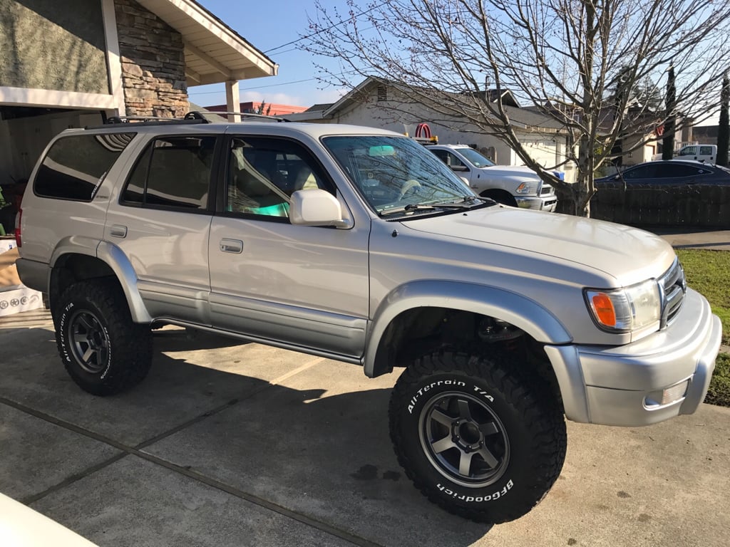

Here's mine shortly after install, can't really compare to anything other than stock. I think they ride great. 3.75s
[/URL]~original[/IMG]
I really like how this looks? what shocks and springs are you running in this pic and how does it drive on highway?

First time posting so sorry in advance if I screw this up, But I just installed the Toytec Superflex rear coils this weekend and I'm really happy with them so far. Still need to test them out offroad and see how they age with time. I'm running an addicted offroad rear tube bumper, a flip down tire carrier, full size 33" spare, and have a sub in the back and I believe they give right between 3.25" and 3.5" of lift in the rear. Install was a breeze and I paired them with the boss extended shocks available through Toytec.
