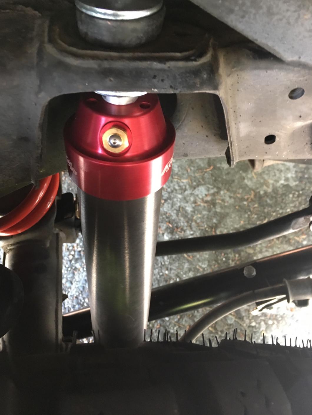

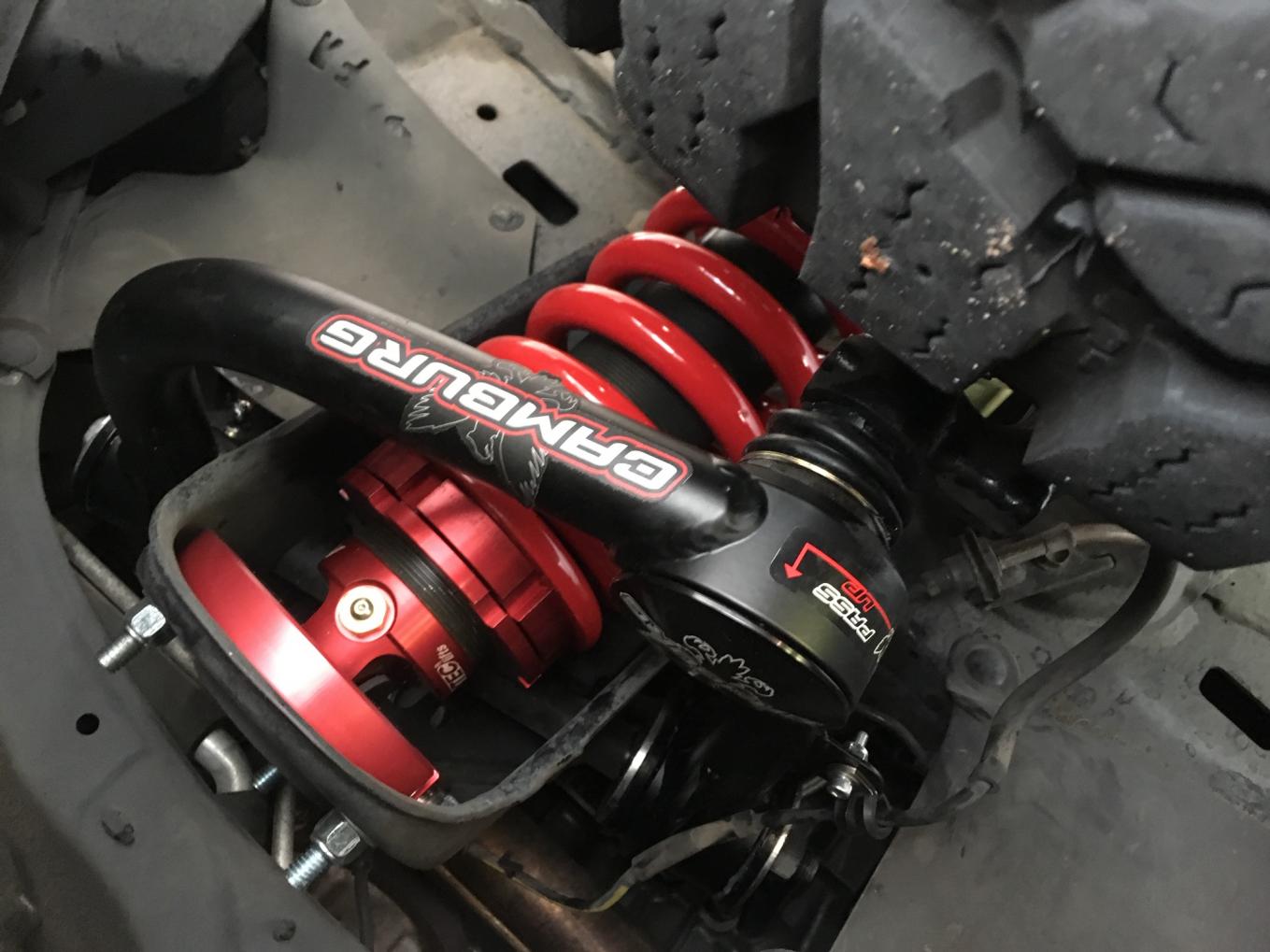

I had these with the matching rear shocks on my 4th gen and they were great. Not sure what I'm going to do with the new 5th gen, but my experience wouldn't make me switch to King or Icon. Mine were made by Radflo, and I bought them for the Red color, instead of the stock Radflo version. Got a discount at the time as well. I checked them out with my suspension guy before hand and he had no reservations about them either. Mine were extended travel which is the only thing I'd change this time. I'm going to check out who makes the Aluma series myself and do some research. They'd go well with my red T4R. Ha!
