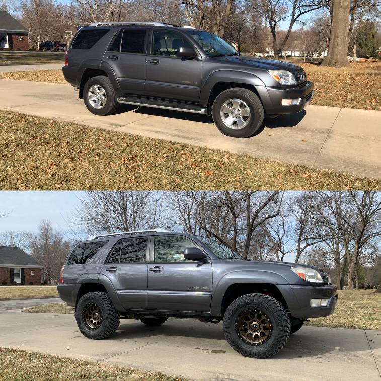

Before and after
Damn that looks so good with those wheels! I definitely want to get a set for mine. We've got the same year and color.

Thanks man. I was really happy with how it looks.
