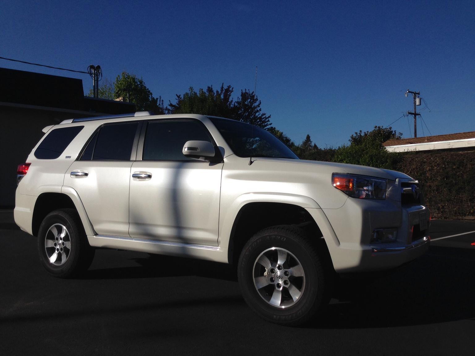

Did anyone else get almost 4 inches of lift from their ultimate coilovers? I was told they come preset for 2 1/2" of lift? I know I can adjust them down, but why was it not 2 1/2"? I have 1 1/4" of thread showing, I thought that would equal 2 1/2" of lift. I have a 2013 SR5
My front fender from the ground was 34" before and now it's at 37 3/4" after. Stock rims and tires.

Thanks for the feedback. I remeasured from the center of the hub and the front driver side is 23 3/4" and passenger side is 24". I think that is still close to 4"? I don't know what stock height is from the center hub.

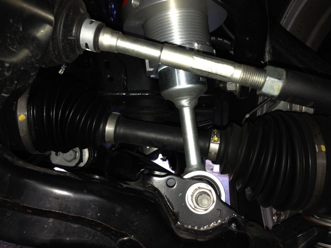

What I am getting at is, maybe it's just your measuring technique? How do the CV angles look?

I remeasured on a flatter surface and it looks like I got about 3 1/2" of lift up front. Our driveway is on a slight upslope so I think that raised the front a little when I was measuring last time. My CV angles aren't the worst I have seen, but they are more than I want for reliability. I guess I'll just have to adjust the coilovers down. I only have a 1" spacer in the back so I only wanted 2-2 1/2" of lift in the front.

Installed toytec boss with saw rear springs and 5100s - so from roktoy's post - it looks like I also got a 4" lift? sounds like I will need to lower the front a bit - my CV's (mostly the inside one) are really jammed up :shocked:

The "waa waa" has gone away, and the boots look much more relaxed (although I still think the inner boot - closer to the drive train - seems squished in, probably still gonna stretch that one about 1/4"), and I have a my "normal" rake back. I've got close to 500 miles on the new set up - gonna remeasure everything this weekend, and then take it in for a "final" alignment.
