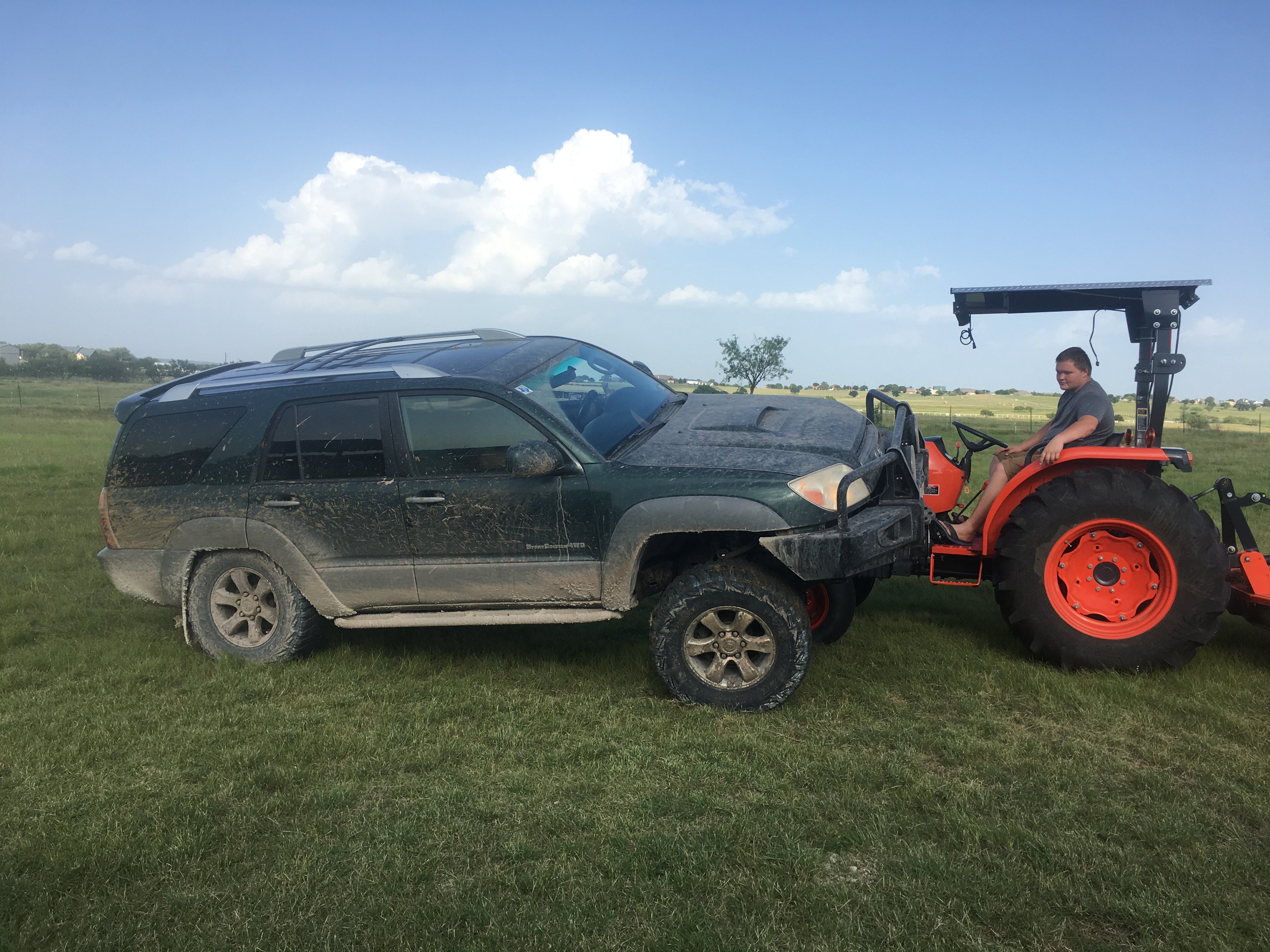

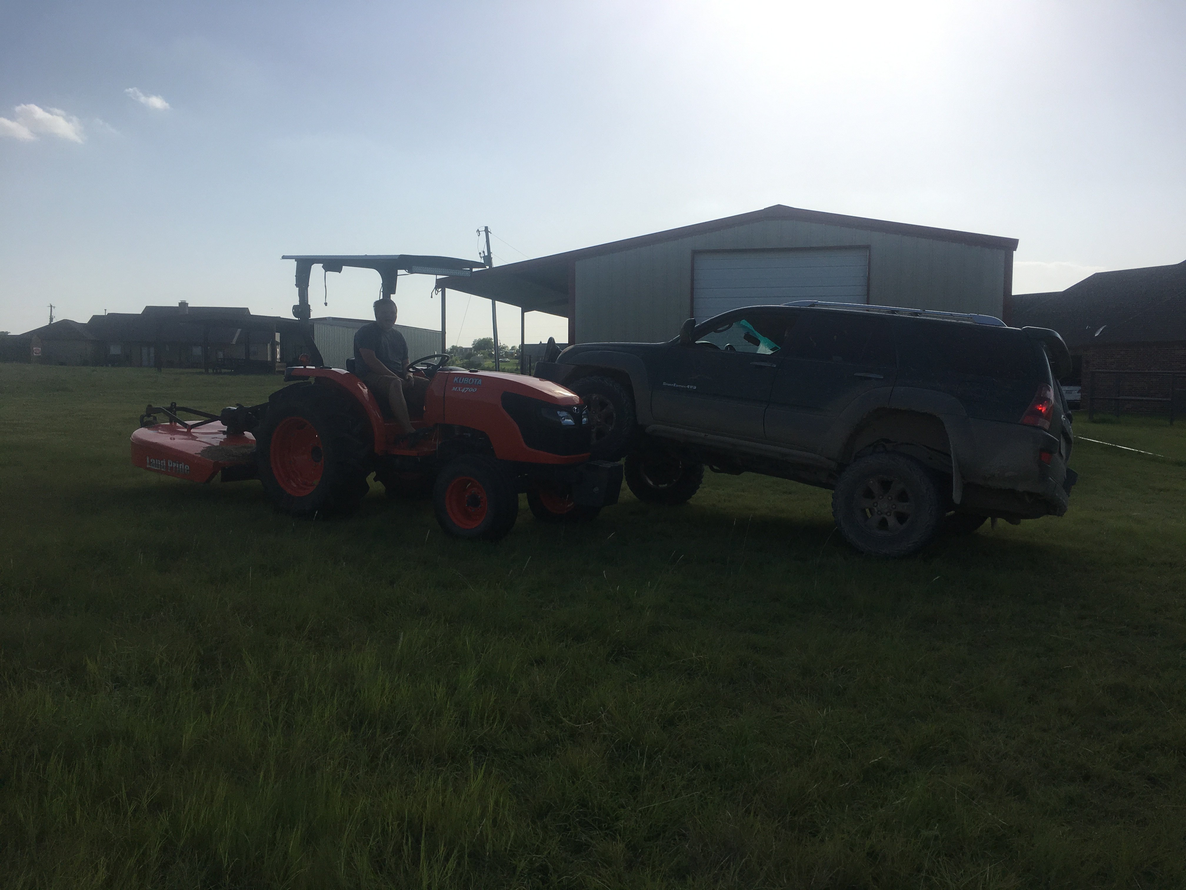

Any flex pictures guys? Please I really care only about trail articulation
Sent from my ZTE B2017G using Tapatalk

The droop / flex between all of those options are going to be pretty much identical to stock.
You have to work within the existing suspension geometry.
If you want to pony up for extended travel shocks and new uniball upper control arms, then you can squeeze another .5 inches of travel out of the shock.
Keep in mind that the less lift you have, the more usable droop you will end up with.
You can dump your sway bars to help with articulation, but if you use the truck as a daily driver you would probably hate the high speed driving characteristic.
In an IFS truck with factory arms, you get what you get until you move into a long travel kit or tear it all out and go solid axle. Two possible options with the latter reserved for the extreme gear heads.

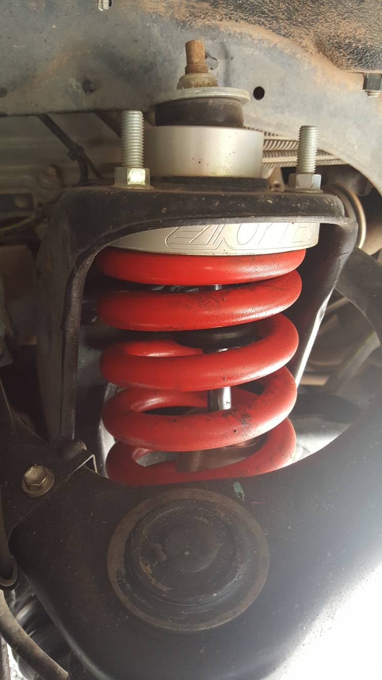

Maybe its just the angle but my UCA looks different.
What I am really curious about is the ICON coilover with cdvc comment from "fordracing19". Did you have to change the UCA like ICON states is required or did you install them with stock control arms?
Mine is a 4th gen, 03 v8 awd. I did add the upper arms as my right ball joint was toast after limping it back 1k miles flopping around since the strut had no fluid left.
Thank you. Based on your observations during the install could the stock control arms work?
