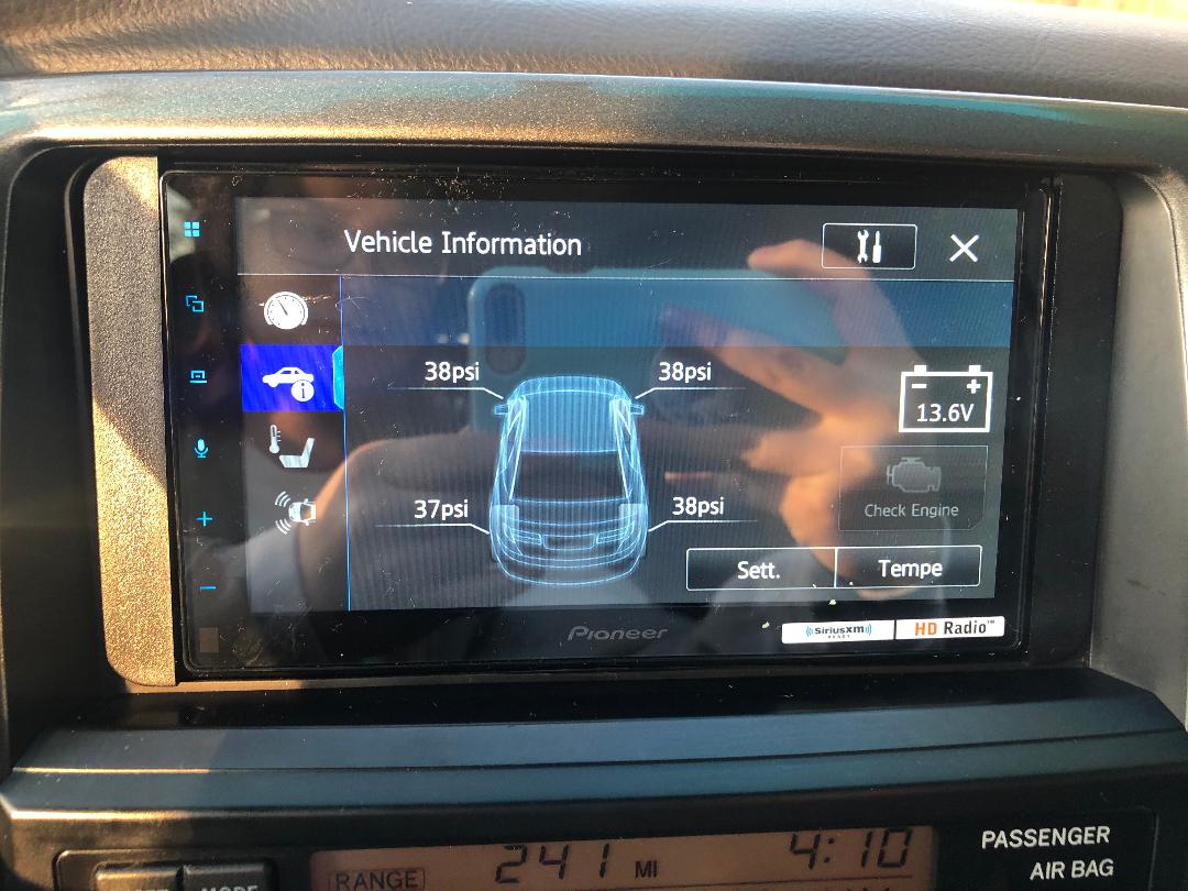

06+ T4R gives added data at the OBD2 port, to include TPMS info.

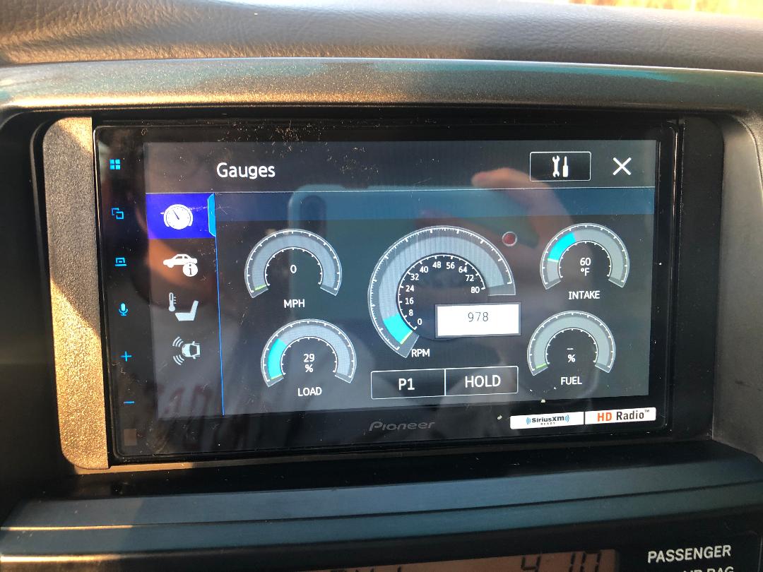

My Pioneer NEX with idatalink Maestro displays the PSI info.

...Is there a product out there that uses the factory TPMS sensors, but provides a readout of actual tire pressures/temps?
I think the easiest and agree with previous poster is to use a new head unit with the iDatalink Maestro RR Interface Module for OBDII readouts within the head unit. Additional plus you also get android or apple interface with use of built int mobile gps apps instead of the factory DVD route.
