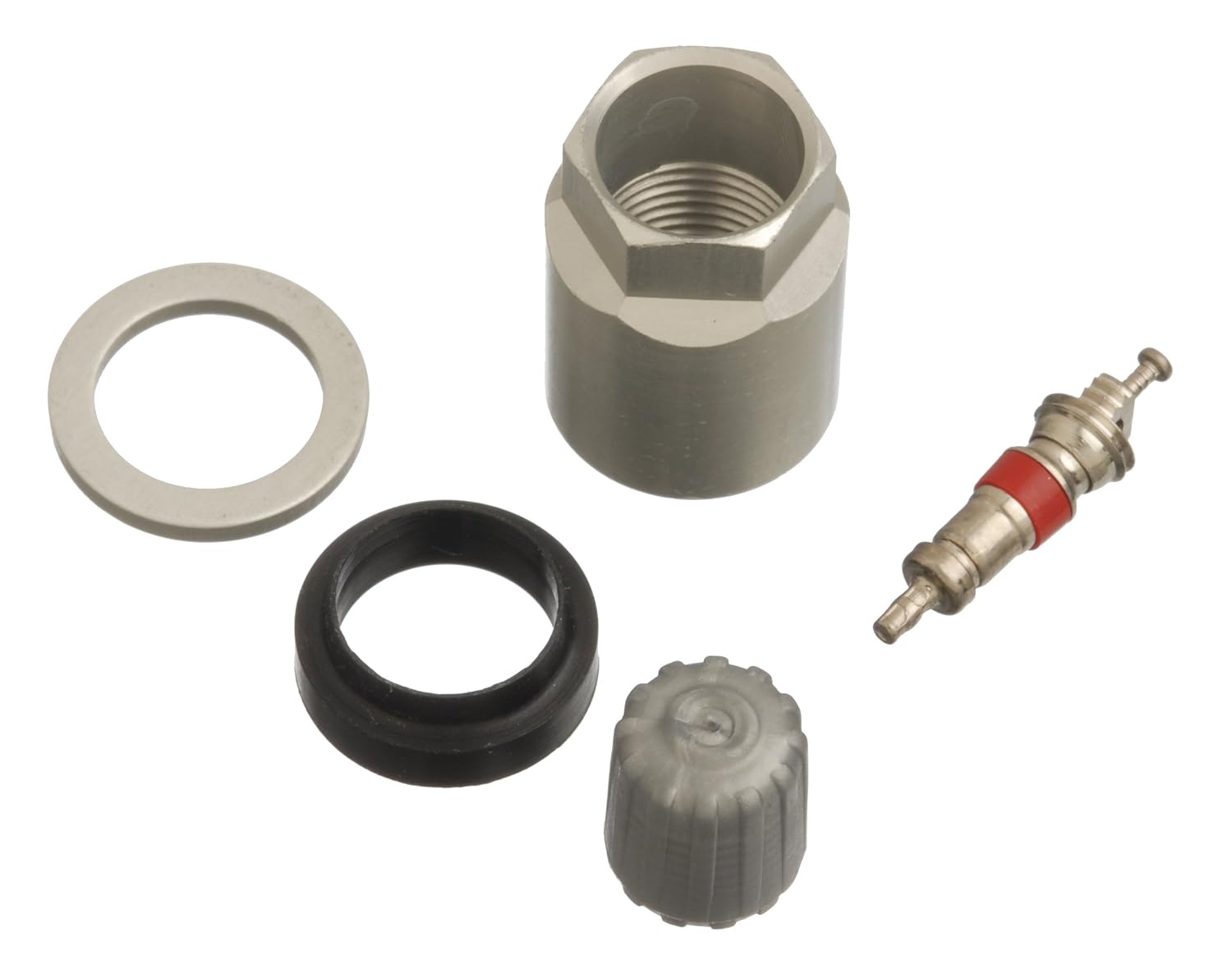

"Rebuild" just means they unscrew the sensor and replace with new o ring, washer, and nut.
This is just doing the service packs to avoid that being a potential spot for a leak. Nothing will need to be done as far as programming for that either.
