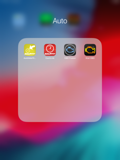

I use a KIWI-3 Bluetooth OBD 2 (pricey, but fast easy connection) but any would work as long as it can pair with the OBD fusion software. Once you download OBD Fusion (free) there is an additional 9 dollar add on "Toyota" package. Once the bluetooth connects you can select which PID network you want to connect to (General, Network A, etc....) there is one labeled "Tire Pressure". IF you select that one and make a new dashboard screen that has the tire pressures for each of the wheels on it you can now access the tire pressures of all 4 wheels. Its accurate as I have deflated each wheel to 20 psi one at a time and checked it. The only issue with this is that when you are in the "Tire Pressure" PID network the only accurate readings are tire pressure and you don't see any of the others (RPMs, Speed, Boost, Oil temp, etc...). You have to log out of that and go into Network A for those to be accurate. So other than that hiccup it seems to work fine. I'll post a few pictures later this evening once I have had a chance to take some screen shots.

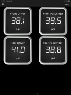

Here is the pics showing the process and what it looks like:
1 - App

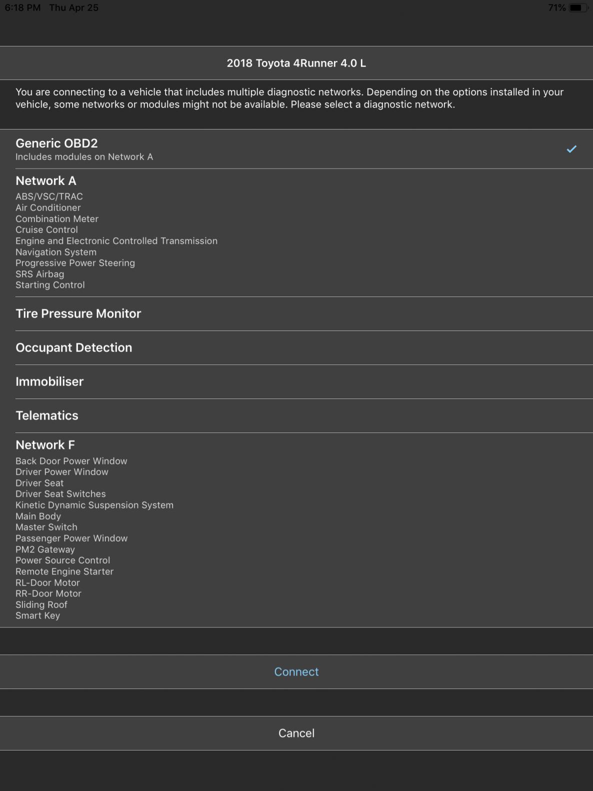

2 - Choosing "Tire pressure monitor" connection
3 - How I have the gauges set up on the dashboard

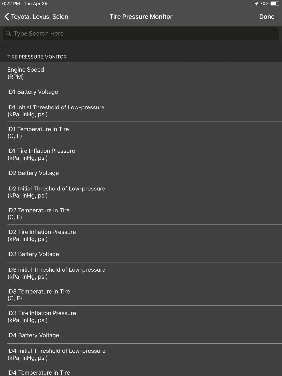

4 - Toyota/Lexus/Scion added PIDs (9.00 Dollars)
5 - ID1 Tire inflation pressure/ID2/ID3/ID4 corresponds to one of the four tires. I don't remember off the top of my head which one went to which. I just deflated a tire to 20 PSI, looks at the app as to which tire was at 20 and labeled the gauge that way.
Hope this helps, and shows you can use this particular app to monitor these pressures. Oh, and the app initially had the pressure in hg rather than PSI, that can easily be changed in preferences on the home screen.

With my 2018 TRD ORP, KIWI 3 OBD Bluetooth reader and the OBD fusion app, as listed above I certainly have working TPMS data. I have deflated one tire to 20 PSI at a time, checked the app and it read 20 PSI while the other 3 read around 38-40 where I run my tires on the daily. Rinse and repeat with the next wheel. Seems accurate to a gauge.

Thanks for the post. Worked just as described.
For what it’s worth, here we’re how the IDs were laid out on mine.
ID1 - driver front
ID2 - driver rear
ID3 - pass rear
ID4 - pass front
(counterclockwise)
