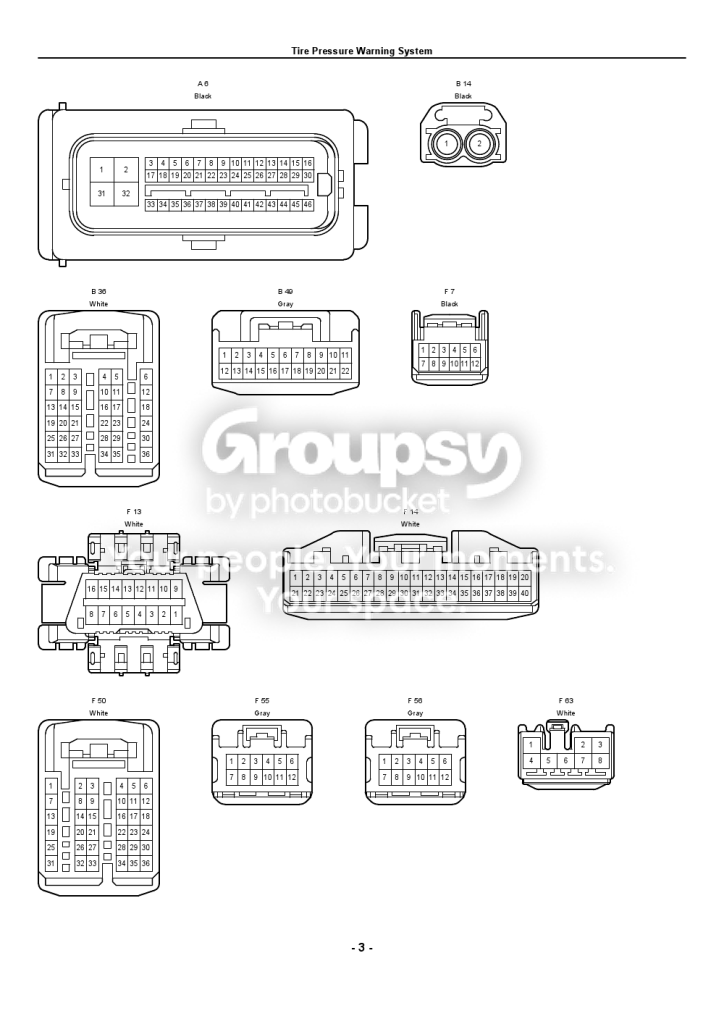

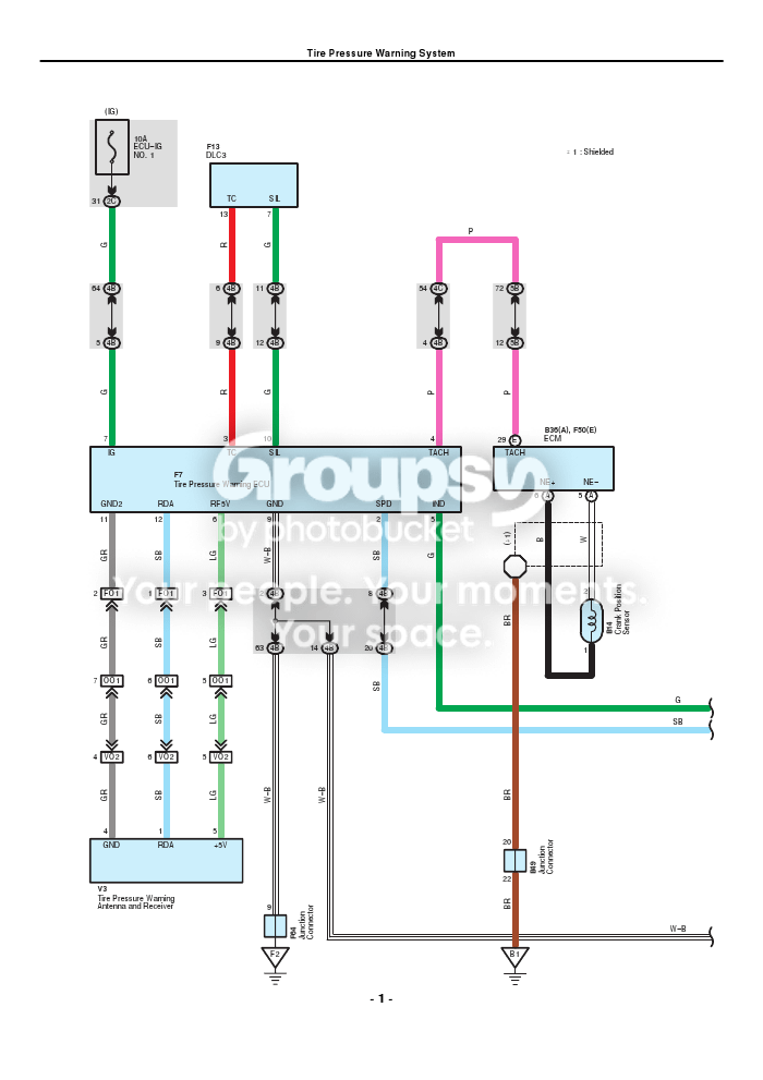

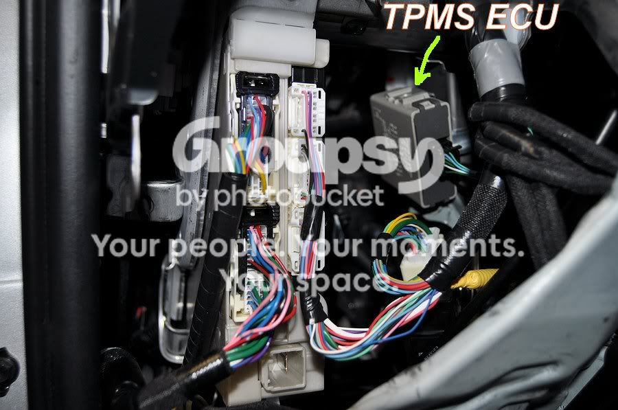

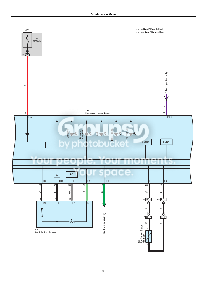

As for just turning off the Warning light...On the 4th Gens, they just had to ground a wire from the ECU so the light wouldn't light.The TPMS ECU is on the drivers side,just forward and up from the brake pedal.It looks like the green wire going to the instrument panel, or combination meter as Toyota calls it, is the one to either ground or make an open. Wiring gurus need to pitch in......
Here's the ECU pic and the wiring diagrams
Picture006-6.jpg~original

Easiest ,should be the green wire from pin 5 on the TPMS ECU F7 connector that needs grounded to shut the light off
