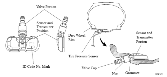

The valve stem is part of the tire pressure sensor. If you have to replace the stem, you have to replace the whole sensor assembly. Going rate for a sensor is about $150, give or take.
For that reason, don't use a metal cap that will react with the stem and lock itself into place through corrosion!
Here's a pic of the valve stem / sensor assembly.
