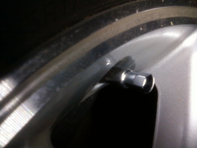

The TPMS system was offered on the 4th Generation 4Runner, became standard after '06 (All vehicles mandated by law by '07 model year).
To identify if you are equipped with a TPMS system, simply look at the valve stem on the wheel, if it is an aluminum valve stem with a 11mm socket cut around the outside then its a TPMS.
My '04 Sport Edition has them.
What are they worth.....just the valve stems?
What I have doesn't sound like what you describe but I'm going to upload a pic to be sure.
Worth? Well we sell them at the dealership at $120-ish per sensor... then you have to have them programed to the vehicle which can only be done at the dealership with a factory TIS Techstream...

Don't believe the 4th Gens use the indirect TPMS system (uses ABS and Traction Control to detect "bouciness" in tires for inflation) so if you had the module in the truck you most likely had the sensors in the wheels at one point, unless someone removed them or broke them.
