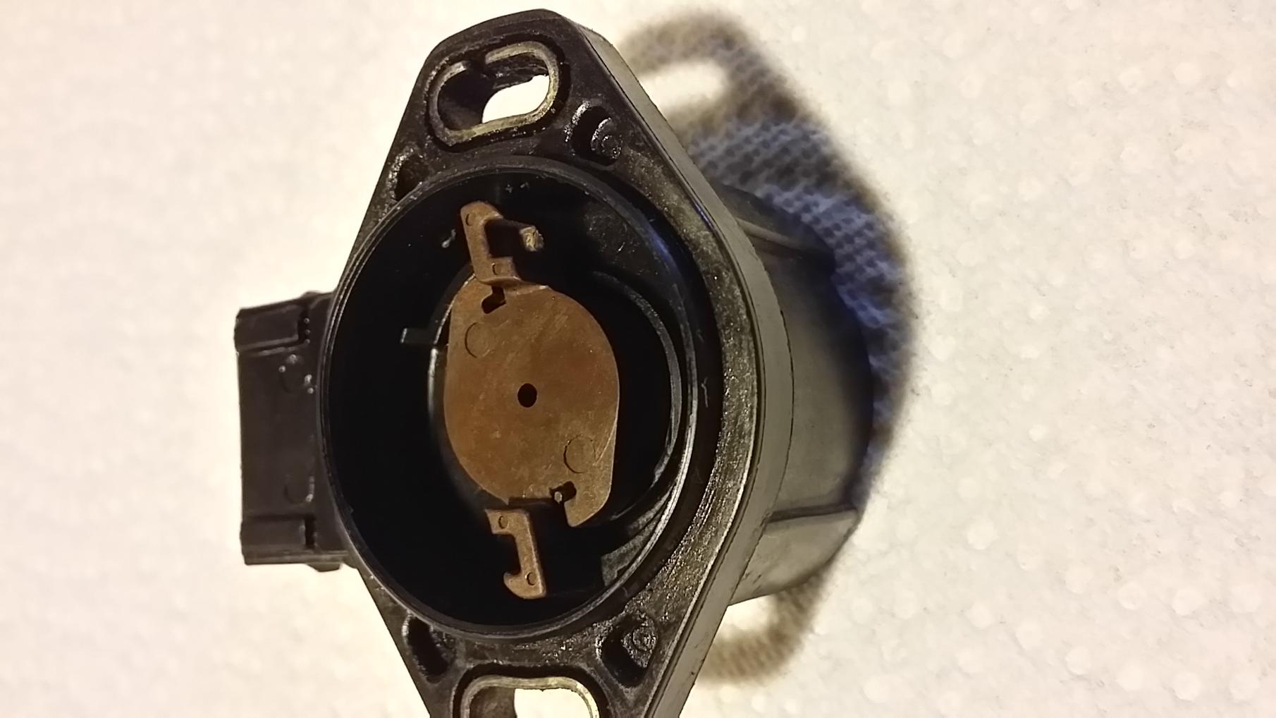

this is the one that came off,the depth of where the tabs of throttle fit into are just a bit deeper on this one,thats the problem Im having,about 1/8 inch or so,and thats making the new one not mount without throttle just cracked open a bit,you follow what Im saying?

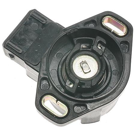

and this is what everybody is selling me,not gonna work,so question is what the hell do I do now??

So, your dealer didn't know that the '85 and '86 TPSs have different part numbers? I don't know why the Autozone and OReillys are selling you the wrong part number, but you need to get the right one.

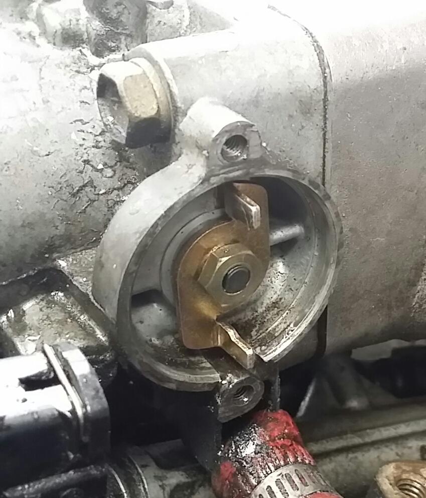

hmm.wonder if my problem is with this? looks pretty new and shiny compared to everything else,maybe.

And from looking at several different pics,no way those flat tabs will fit into any tps sensor Ive seen,maybe Im wrong though,dont have another throttlebody to compare it to,any thoughts?? what I get for tryin to fix this thing in the dark,we dont get much daylight here in the winter
Well SOB,I got it figured out,its because I was installing it wrong,so now finally got ahold of somebody here whos knows these things,gotta peel throttlebody off take it to him and he is going to set it because its automatic and he is familular with it,so mystery solved live n learn,but thats what it takes,nobody taught me much bought a car couple books some tools and 33 years later still learnin,hah....thanks for the input anyhows,cheers!!
