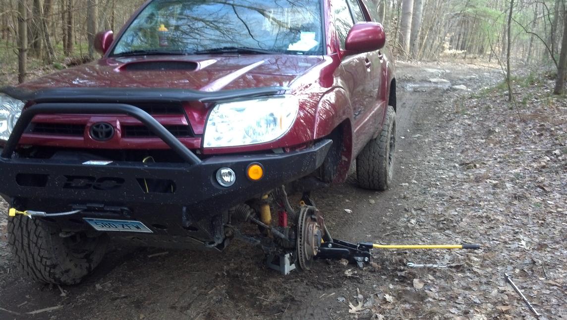

I took the family for a little trail ride, easy stuff. We bombed down a dirt road and turned off into a bug muddy rutted section with some speed to keep things moving. Of course I hit something in there and kinda launched the front end a bit, usually not a big deal. After the mud hole there is a trail with rocks and ruts, as soon as we hit the rocks i slowed down because I heard somethig wrong with the front suspension. What do you know ? lost the top nut for the shock which then came out of its mount and then the shock rod caught under the shock mount plate, pushing the whole thig down , way down. I think beyond normal compression. I had all my tools with me so I ended up getting it back in but I had no nut so I had to cross thread on of my lug nuts on it to keep it in. WHen I dropped the jack under the control arm the shock released because of the downward pressure and the cross threaded nut was holding it in. It was as though it had been hung up some how and went back out the whole way when i put the weight on it. Not good. Does anyone know what size nut that is ? I couldnt find it at the Home Depot and its sunday so nobody else was open. Im going to get 2 new shocks i guess if the threads are shot. Running 886 OME springs, any suggestions ?

Is that stud thats stripped hardened steel? If so, can be hard to tap when stripped.
I decided that because the shock was over compressed and I had already destroyed the threads to just order new OME shocks. Figured its better to replace them both at the same time and they are made to work with the ome springs so... $300 bucks from amazon, hope i get them this week so they can go on next weekend. I was tempted to get some sexy coilovers but not for 800 bucks on the low end, no thanks.

It was kind of my fault I think, that side had been making noise so I tried to tighten it down more and I may have damaged the threads. The threads were all rusty from 3 years of road salt, not sure but It seems strange it happened a couple days after I had messed with it. OME is great stuff and thats whats going back in.

I tried but the straps I keep in the truck were too big. Beleive me I tried that. I will be getting a smaller strap for the 4runner to serve this purpose. As well as an extra top nut for the shocks j.i.c. The reason I had a hard time compressing was that I had to compress much more than normal since the shock was stuck in a compressed state. I had the whole weight of the vehicle, jack stand on opposite rear corner to fight the flex, plus my fiance on thefront bumper and the kids in the front seat , but I still had to pull down with all my weight while I cross threaded the lug nut on the first couple of threads. Then it released pretty hard with a pop when I let the suspension drop. Anyways new shocks due to be delivered the 24 th plenty of time to repair for the trail run that weekend. :biggrin2:
