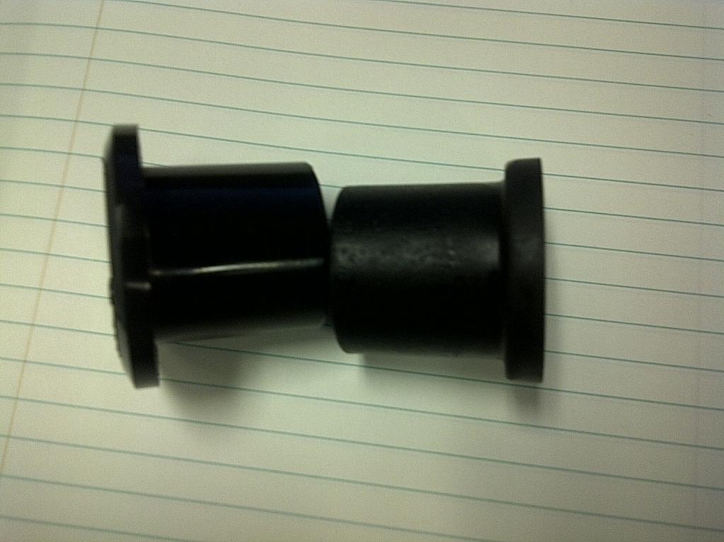

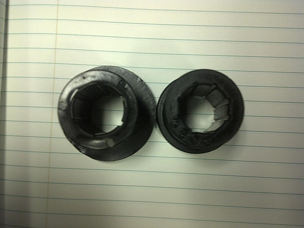

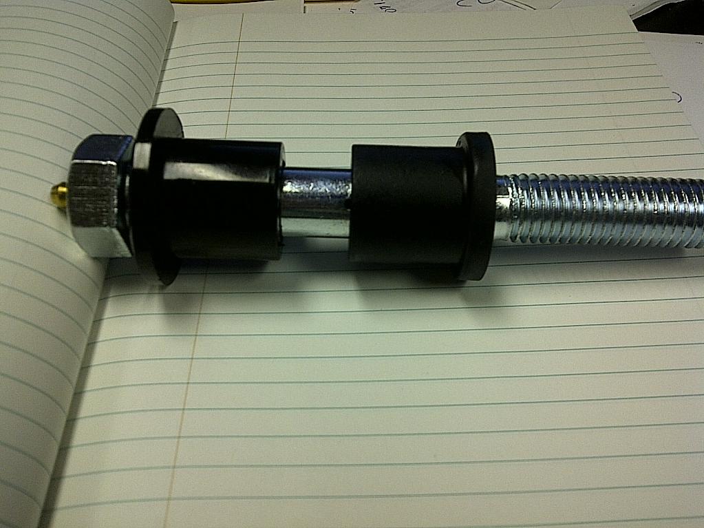

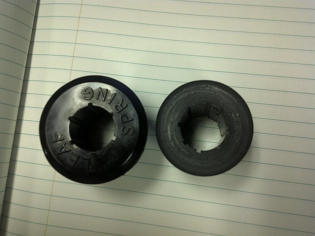

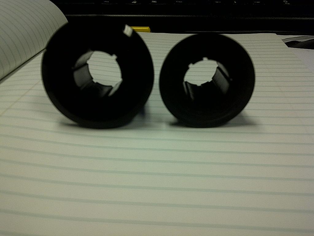

The bolt is an M18, so it won't need the sleeve. Both the trailgear and energy suspensino bushing slide over the bolt. The trail gear material looks shinnier and smoother, and seems like I can squish it more than the energy suspension.
The energy suspension seems harder, and feels oily/greasy...slippery and it has a smaller flared end and it is a much tighter fit around the bolt.
The trail gear turns around the bolt with ease. Meaning that I can spin it around. The energy suspension does not, it is a tighter fit but no effort required to slide it on, but just a snug fit.
Which to use, which to use.??
Here are some pictures. The left is trailgear, the right is energy suspension.
I wanted to use the energy suspension, as my understanding is that they may not disintegrate very quickly. But seeing that the trailgear can easily spin around the bolt, makes me think that it may give smoother motion and less bind. But i wonder if I really want that, but instead should be looking for some resistance and a snug fit.

I'm no expert, but I'm thinking that the harder material will last longer, and the snugger fit will lead to longer life as well. I'd use the ES bushings.
