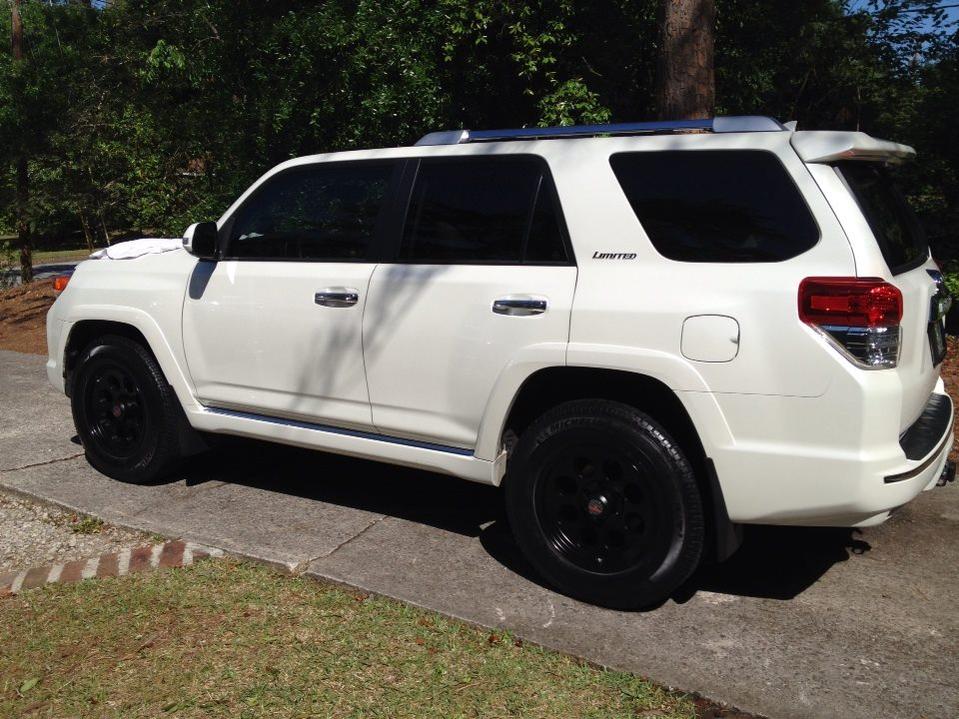

I just took off my 20s and put on 18x9 level 8 grappler in matte black. went with 265 70 18 rubber. very slight rub at stock height but i fixed it with five minutes of removing plastic from fender.
18x9 Level 8 Tracker on 265 70 18 rubber. no lift. very little rub. fixed by removing one piece of plastic on fender.
here is the pic

The black wheels on white look great. I'm also planning on doing that.

i got the wheels from discount tire website for $504.00 for the set!!! i got the tires at the local discount tire store for $900.00. i needed new tires and was gonna have to buy them anyway. I had to get rid of those stock 20s. i did a ton a research. if you go 18x9, you can run a 275 65 or a 265 70. i had to remove a small piece of plastic that is part of the mudflap but was able to leave the mudflaps on. i am not handy at all, so i was amazed that i was even able to do it.

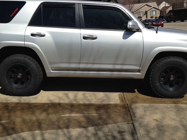

I think your actual tire size on a 17" wheel is going to be the determining factor in whether or not there is any rubbing. I currently am running 265/70/17 (SR5 stock size) BFG ATs on 17x8.5 Level 8 trackers (-6 offset IIRC). I haven't done any mods to the fender wall , and I haven't had any rubbing issues during normal driving conditions or mild-to-moderate off road conditions. That said, I haven't been at full stuff yet, so maybe there could be some rubbing in that specific instance. If you are trying to cram 285s in there without lifting your truck you're more likely to run into issues.
Pics!

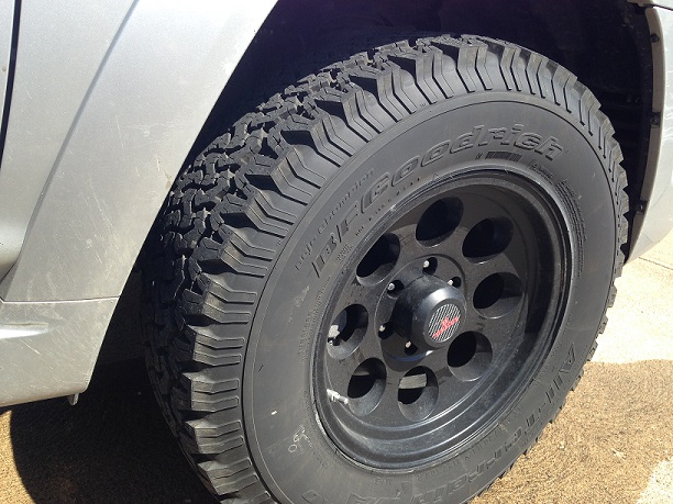

A few of us have the American Racing Mojave wheels in 17" After two years with them now I'm still very happy with them.

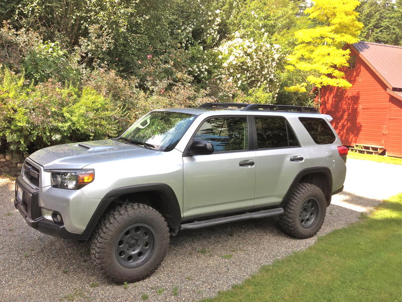

There's been some good threads in the past on picking black wheels, like this one. I do love my V-Tech wheels (from Discount Tire) but I also see people have had great results just taking some stock wheels and painting them black, which you can pick various amounts of gloss or flat to your liking. That sort of FJ phone-dial type wheel painted black i think looks great!
Like others here i had to remove a plastic piece in the wheel well due to negative offset of my new wheels.
