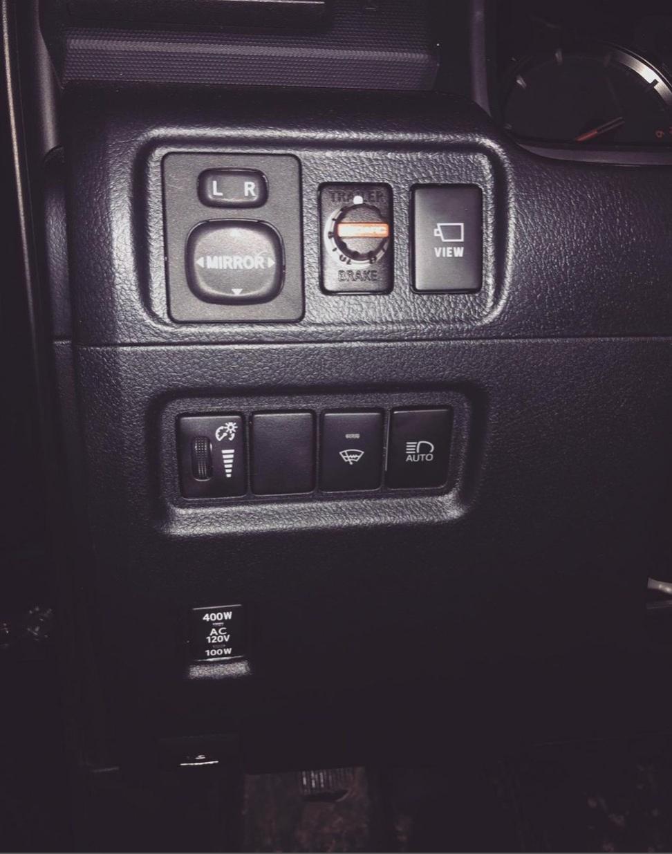

I recently installed a redarc towpro elite and the install is easy. I used the factory pigtail harness, however I'm going to switch to the Tekonsha harness this week as I believe I have a ground issue with the factory harness.
Also, depending on the switch location, you may need to file or Dremel out the opening for the switch panel/plug to seat in, easy none the less.
Wish I could provide more on operations but the dual modes are going to be nice...
Update: troubleshot the suspected return issue I believe I was having with the factory pigtail. Buttspliced the Tekonsha 3041-P harness and grounded the redarc
harness common(white) to chassis ground. All is good in the neighborhood...tested- verdict=sweet brake controller

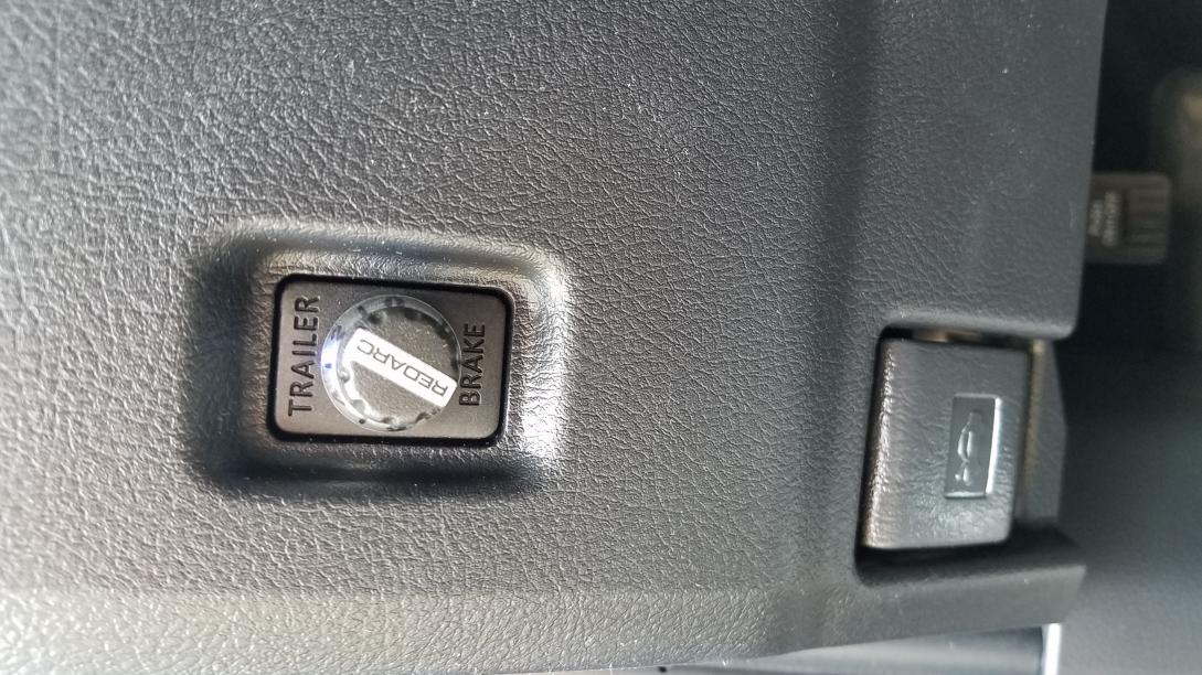

I installed the Redarc tow pro elite as well and I'm happy with install and performance. Really clean looking switch. I used Redarc's harness specific to 4runner rather than the factory or Tekonsha. The Redarc harness plugs in directly to the socket at the kick panel and straight to the Redarc control unit, no spicing anything anywhere. I also bought the switch insert like [MENTION=139970]greatape[/MENTION] but more specific to the 4runner... at least it fit into the opening better than the TPSI-001 with no filing etc.
Redarc wiring harness for 4runner PN: TPH-021
Redarc switch insert PN: TPSI-002
