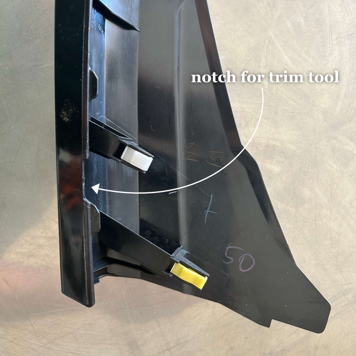

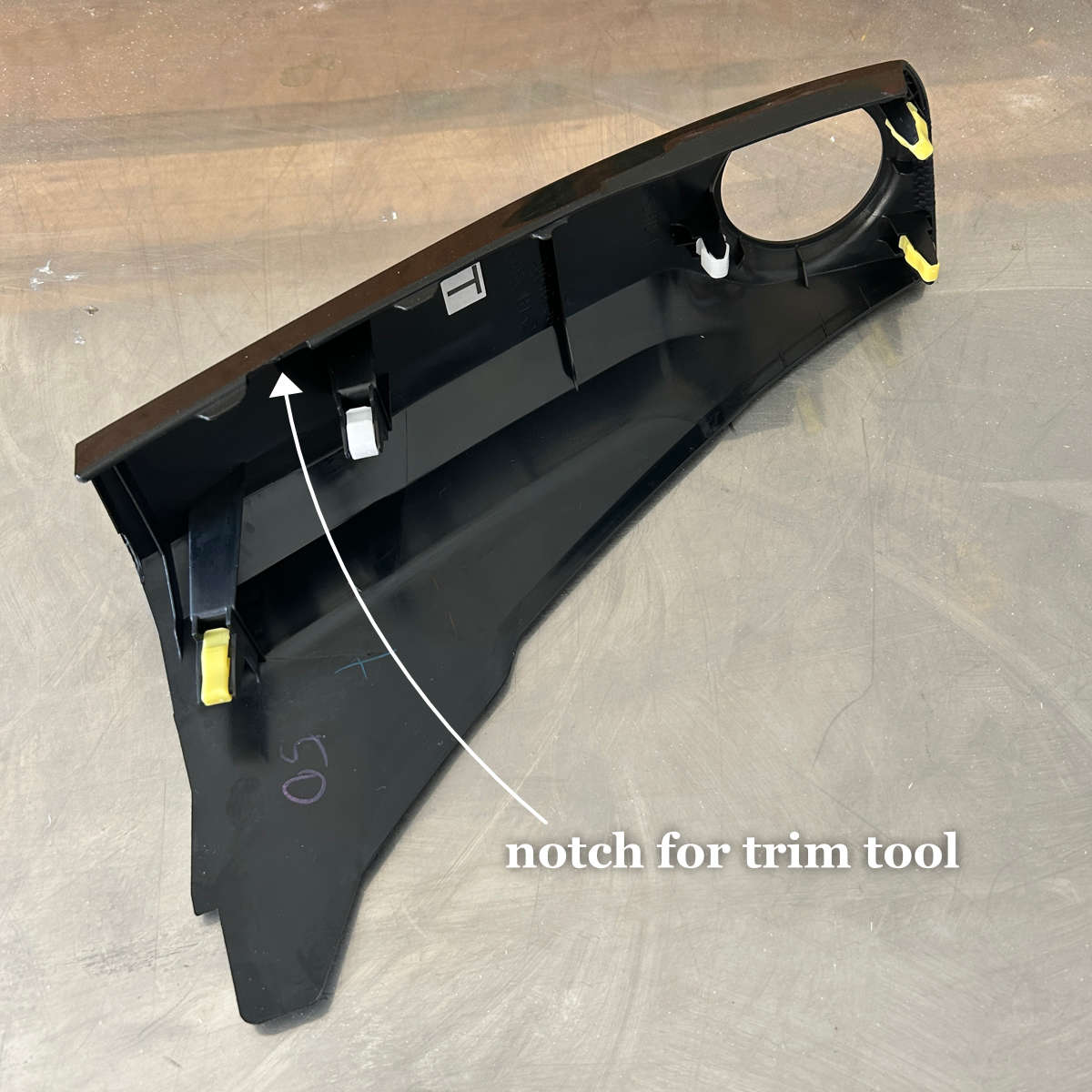

I had a heck of a time getting this piece of trim off.
I could not budge it using my fingers. There is not a lot to get a grip on.
I finally got it off using a trim tool and discovered the place that Toyota probably provided for inserting the trim tool after the fact.
I'm posting some pictures here with the hope that they will help others.
When you remove put a piece of masking tape on the dash to avoid scratching when reinstalling.
I wish I had done that, but luckily, I ended up with just a bit of blemish on an edge that was mostly hidden from view when everything was put back together.
