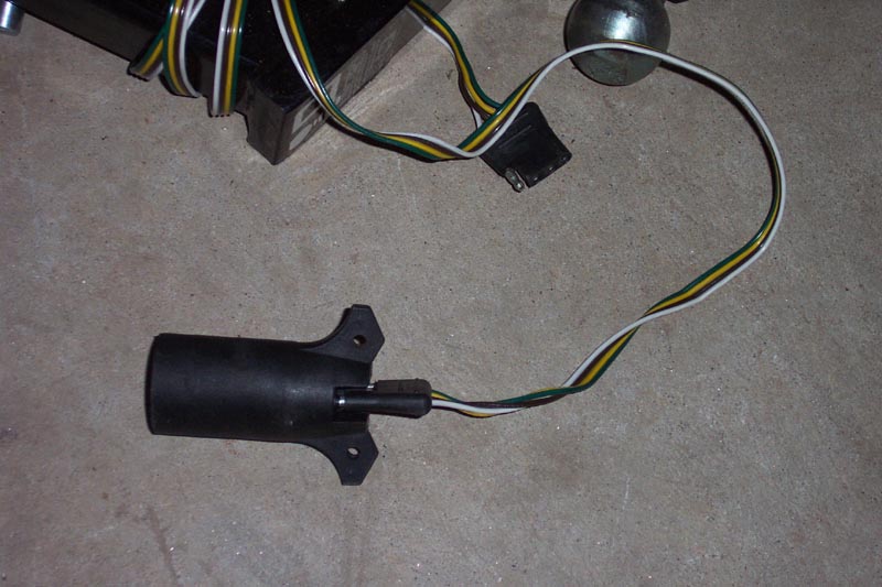

The wiring kit that comes with the truck is for electric brakes for a trailer. I have a small utility trailer with 4 wire harness. It used to be connected to the brake lights on my sedan using an adapter kit.
For my 4runner, I bought a Toyota Plug to 4 wire trailer harness adapter at the local camper place for about $20. The 48 inch cable was $8. All the new 4runners have a trailer jack below the bumper. It is capable of 7 wire connections (hence the ability to control electric brakes).

The one in the glove box is for connecting trailer electric brakes. It's in the manual somewhere. You must purchase your own trailer harness. There are a lot of adapters sold at auto parts stores too. They were all sold out of what I needed for my 4runner, so I went to a camper place and they had everything.

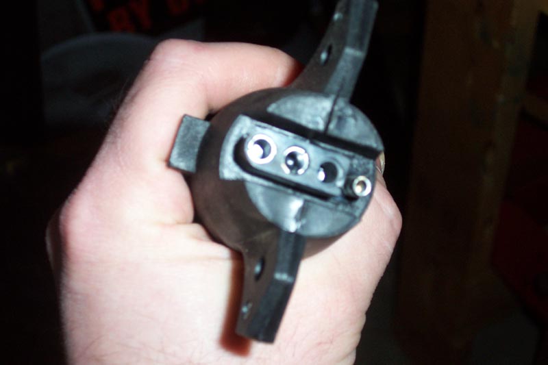

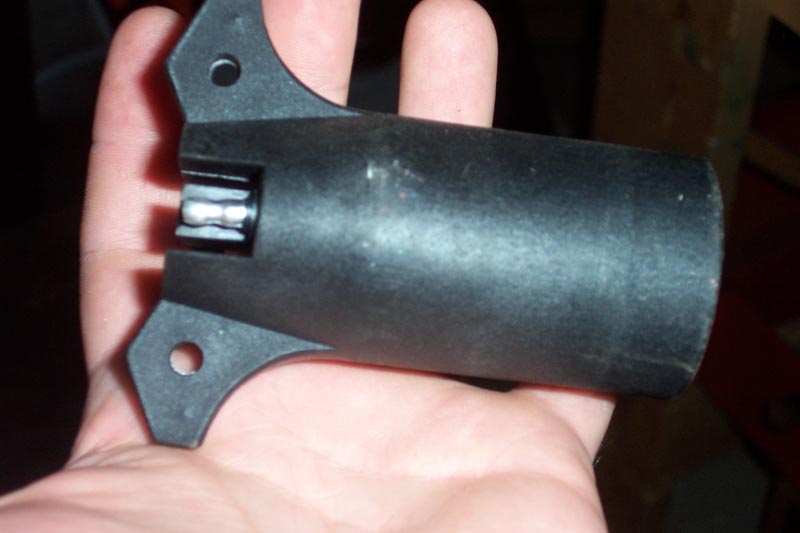

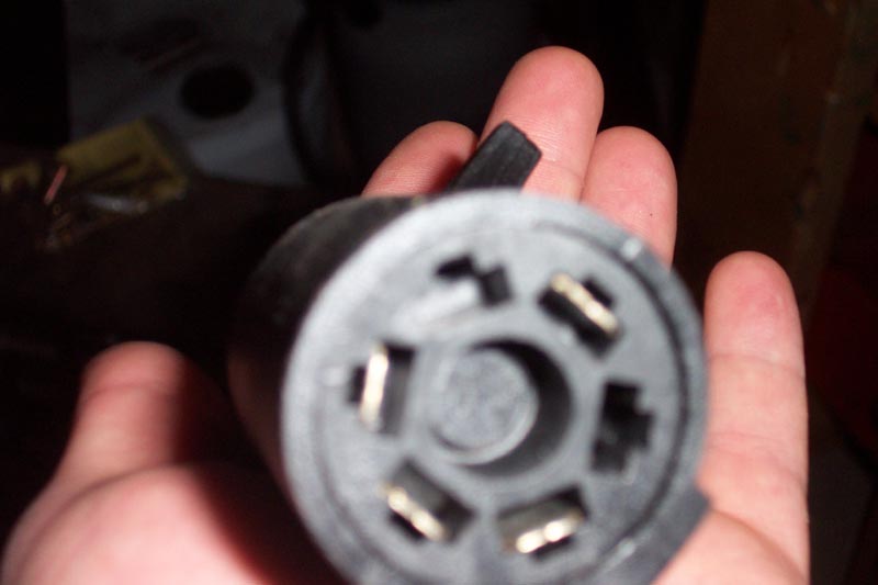

The picture shows the adapter , it is a barrel shaped plug that will fit the 7-pin toyota socket. Depending on the trailer you're going to tow, the other end needs to be the right kind of plug. Most small trailers are 4 -wire type flat connectors, since they don't have elevtric brkaes. When you start to approach 2000 pounds, you should get a trailer that has it's own brakes for safety reasons. Thats when you will need the brake wiring harness in the glove box.
7 wire toyota end
You notice it isn't rigged for doing electric brakes, it's missing connectors. Only 4 electrical pads.
