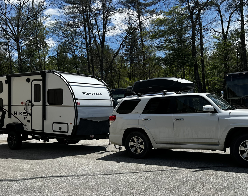

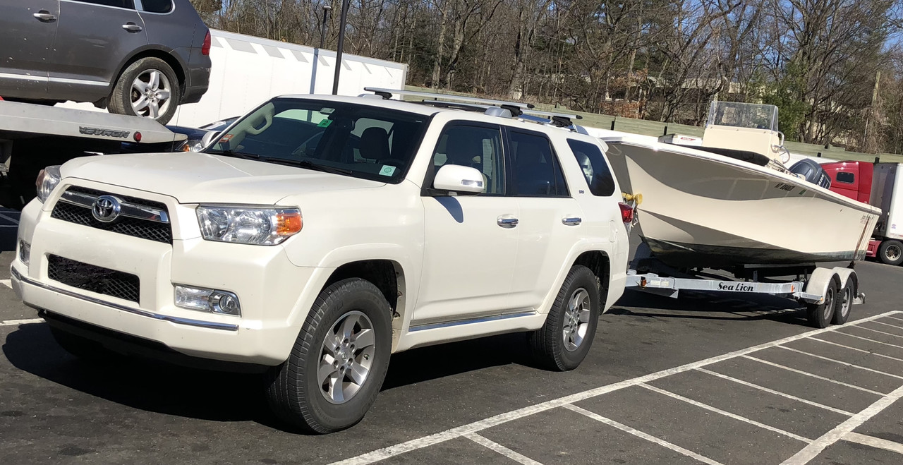

I tow both a boat and a small Winnebago with my 2012 4Runner. They both come in around the 4,000 pound range. There is obviously a difference in tongue weight I have to figure out. The boat does not give me any sag, but the Winnebago does.

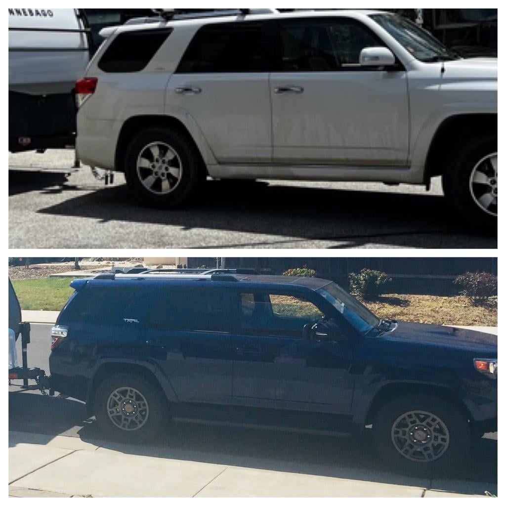

The scary part about your trailer picture is how much weight is OFF the front tires. That’s extremely dangerous. WD hitches are designed to swing the weight back onto the front axle.

Not sure if it will show up but here’s a side by side of our setups. Look at your front wheel to fender gap.
Here’s mine full view

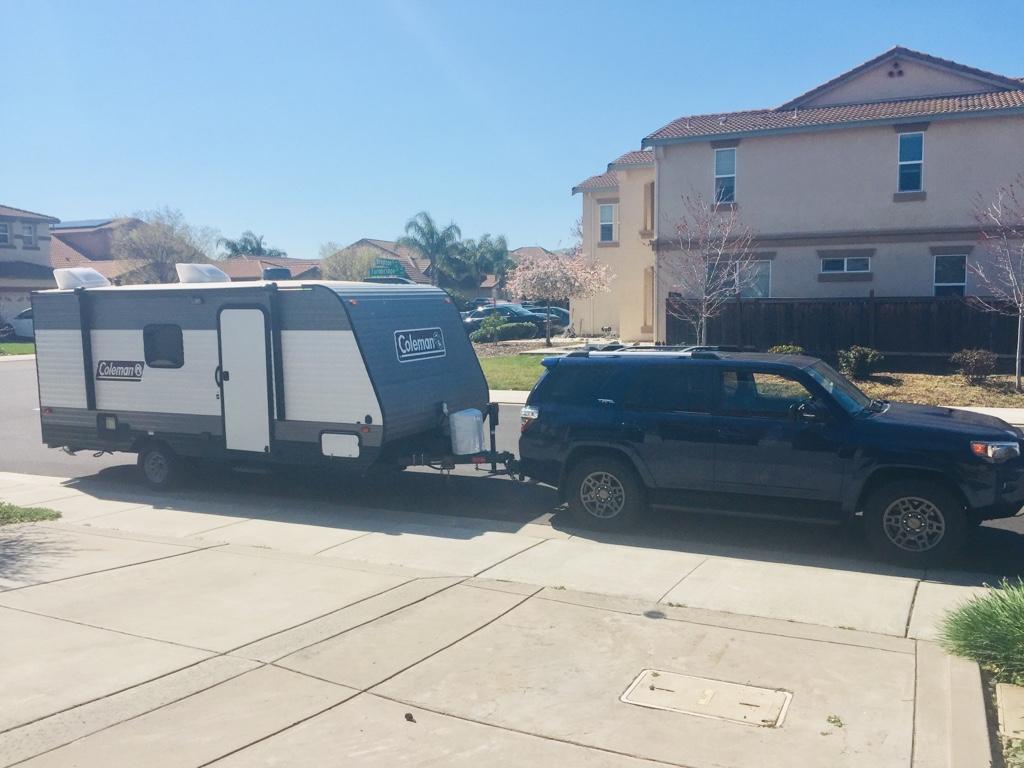

3500# Coleman trailer. Tongue is probably same weight as yours. I even had to add airbags too. Firestone. Inflated to 10-15psi and it’s a fine ride. Totally comfortable even 2 adults, 2 smaller kids, and ice chest FULL in the back of the 4Runner. Some folks get worried that the 4Runner can’t have WD hitches but I haven’t found any Toyota based writing for our 2016 that says specifically not to use one. 1500 miles of towing on ours

I second the concern about the ride attitude with your 4R hooked up the the camper.
It's apparent in your pics that the boat trailer has 2 axles and the Winnebago camper has one. With the rear end sag that your pic shows with the camper, I'd say that you have way too much weight on the hitch with that unit. Can you pick up the camper by the tongue? Maybe you can redistribute the load inside the camper? Or maybe there is a way to adjust the camper on the axle?
Does the boat trailer ride OK? If so, and the two towed systems are about the same weight (find a scale?), then I would really try to adjust the tongue weight on the camper.
