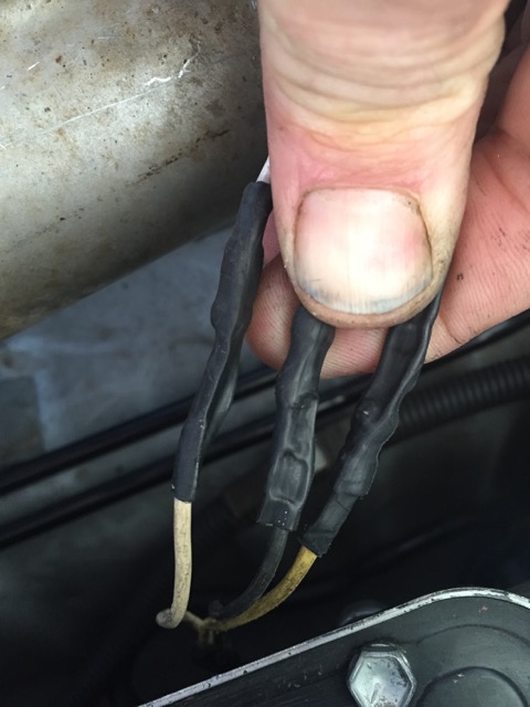

Anyway the end of the troubleshooting story was spotting the smallest tiniest bittiest short I've ever seen; apparently two adjacent sharps on two splices had tunneled pinholes through the perhaps crappy quality shrink tube, and shorted out solenoid #2 to the Lock Up Solenoid.
For future researchers, that explained A LOT about how a malfunctioning tranny solenoid issue might feel; note that with this particular short, whenever the #2 solenoid kicked for low speed upshift, the lock up solenoid was getting some voltage too, which apparently made the transmission hard as hell the turn, which in turn lugged the engine rpm's down, likely sending all sorts of conflicting signals the the ECM, which sent out scatterbrained commands to the e&t.
In 1st or 3rd/OD, there was less or no apparent problem with the solenoid cross talk, until when the lock up signal inadvertently tried to engage #2 out of sequence, and transmission would again hunt for a good gear to be in.
While the precise root cause of this problem (splices working thru insulation til shorted) probably does not exist on your truck, be aware that if your tranny starts herking and jerking, it's super just super easy to meter the solenoids as a front-line check, and a common problem point.
I can only guess the transmission maybe got extra hot on that hill decline and the tightly tape wrapped wire bundle pressured two sharp spots through their shrink tubes, perhaps explaining why the symptom started at that exact time.
The picture below is of the wire short. One short is that 2 pixel large bright spot on the right hand wire, shorting to the even smaller spot on the middle wire- do not adjust your monitors, you're already looking at a magnified version cos NO my thumb aint that big.
