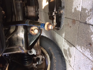

So it looks like a new radiator at a minimum. The return line fitting was pulled out of the radiator. It is a threaded fitting and it wouldn't screw back in. It's like the female portion on the inside was pushed in, the threads wouldn't catch. I couldn't see any coolant in the radiator and the dipstick didn't show any transmission fluid so I am not sure if any coolant got in the transmission, but I am thinking not or just very little.
I guess I will swap in a new radiator and drop the transmission pan to clean it out and replace the filter. We'll see after that.
