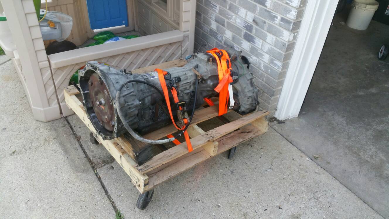

Tranny is out of the donor vehicle. Rented a gigantic tranny jack from the hardware store in town, 15 bucks for the day. Took maybe an hour to actually pull it, wasn't too bad at all.

Nice. Looks good. Like fellow member [MENTION=50342]JayRolla[/MENTION] said, they are only big Lego pieces.
Doing the rear seal as well?
