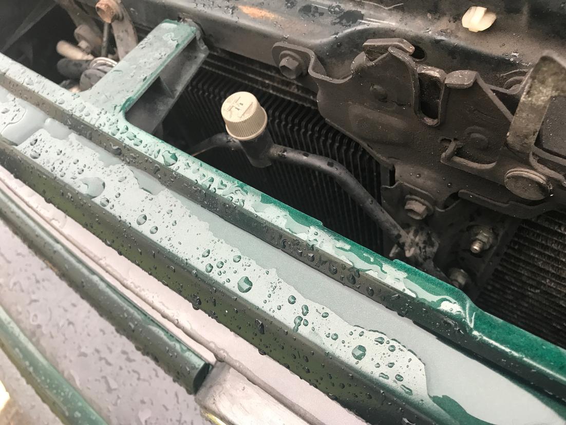

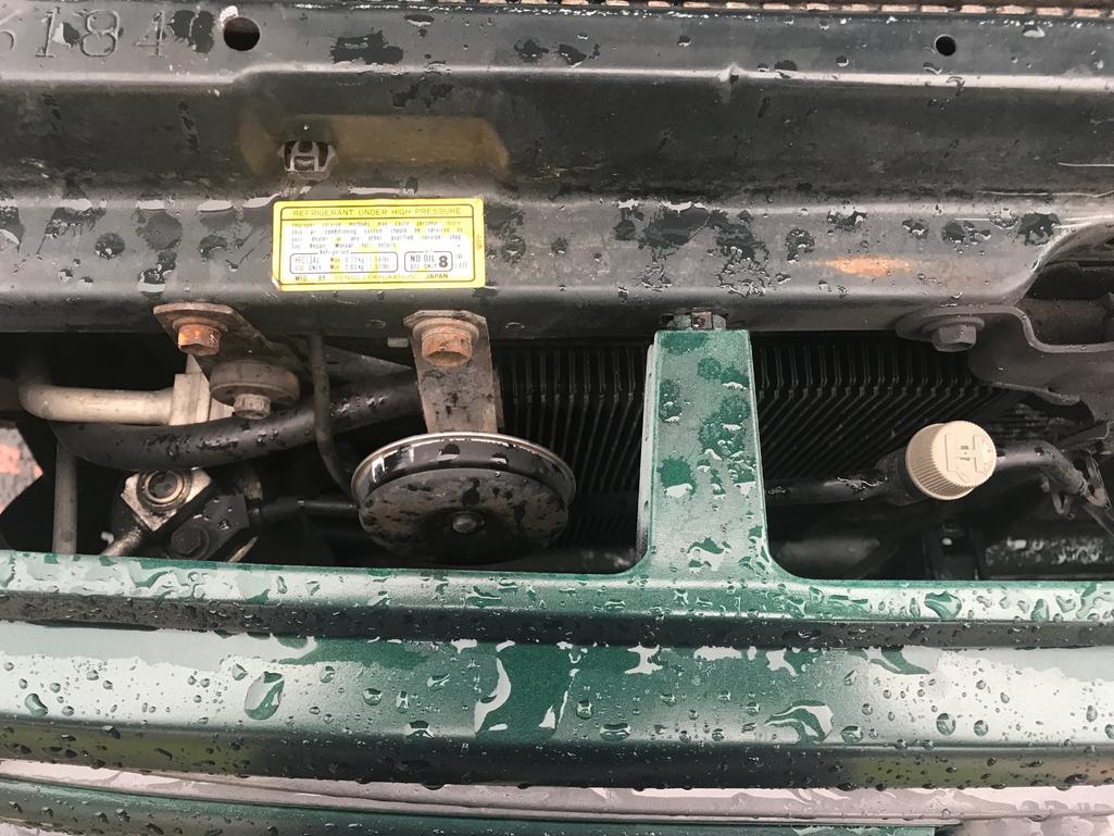

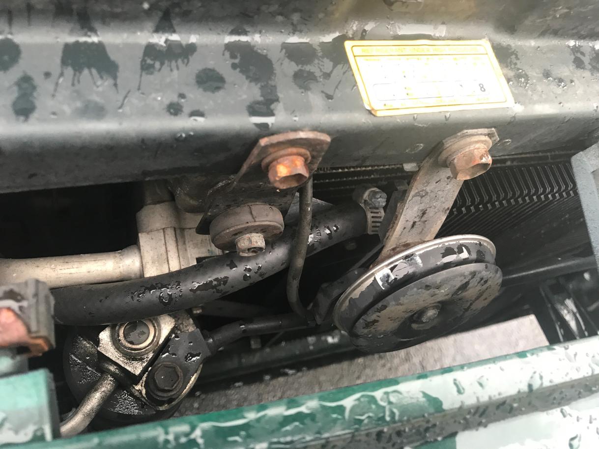

I feel like an idiot but is this what I think it is? Since I didn't know much about these I didn't even check for that when I bought the car. Then yesterday I was checking the coolant and run into this surprise.
That is more than likely a trans cooler tucked back there. Follow the rubber hoses down and see if they go to the top of the passenger side frame where the two transmission hard lines are.
