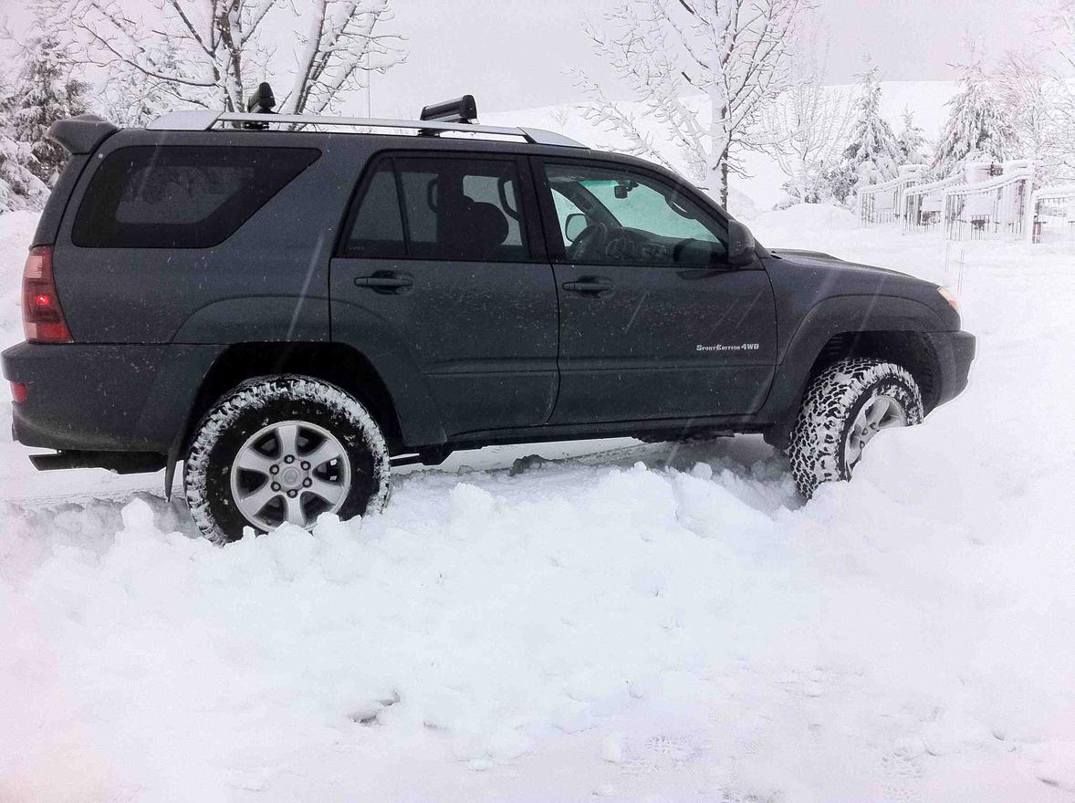

Here is the deal. I live in Massachusetts. We just got 18 inches of wet snow. I was fooling around in near by unplowed parks with a very steep hill. Truck was struggling to get traction. Put it in 4 low. Then decided to turn traction control off and lock the diff. Both the 4 wheel drive low. and diff locked. I am positive. I engaged both of these while in neutral.
Here is where my problem occurred. I couldn't turn the lock diff off and turn the traction control on. After using it. Once i got to a flat road. Put car in neutral and tried to turn traction on and diff off. both in 4 hi and 4 lo while car was in drive and while in neutral. Still wouldn't turn off. Then i parked car turned it off. Turned back on and finally got it to switch over after a few trys. by switching over i mean i was able to unlock the diff and turn traction control back on.
Tried it again later just in my drive way. The truck allows we to go from 4hi to 4lo and turn lock diff and traction control on and off while PARKED...
As soon as i try to drive the truck with a locked diff and traction control off i struggle to get it out of a locked diff and to turn traction control back on....
So it seems the system works while not parked. I am sure it is engaging 4lo and am sure the diff is locking and traction control is off when i press the buttion. I can feel it when i drive. So it has something to do with once i drive the truck then try to get back out of a locked diff and no traction control.
I checked the manual and didnt see anything. Am I doing something wrong. does the car have to be in 4lo ? and does it have to be in neutral. I dont remember ever having this problem before when i wheeled it.
Could be user error or bad transfer case.. What do you think? Good news is if my transfer case is going care is still under warranty..
BTW it is a 2005 Sport v8 4x4.. Thanks in advance for your help!!!

Not following completey but you're saying the center differential is difficult to unlock after having it locked on snow, correct?
More driveline windup can occur on snow than you might imagine. That can make the diff a little hard to unlock especially if you're just sitting in one spot.
Test turning it on and off while driving in a straight line. You can play with the accelerator a little to help it along if you wish. It should go on and off pretty quickly and easily.
That's correct jb. What do you mean by windup.
And no not trying to switch it over on dry pavement roads are covered in snow. So I have to be driving in order for the diff to unlock?

It's the pressures caused by the front/rear drive shaft being unable to turn at different speeds. It can make the gears in the transfer case get kind of wound up tightly, making the unlocking more difficult.
No, but it makes it easier especially if there's any windup.

This happens on center diff locks on other trucks as well, usually when they haven't been used much. Some guys have jacked a wheel off the ground and rotate it back-and-forth to make sure all the windup is out of the drive-train. If the actuator was unable to unlock it might have burned a fuse trying, check those.
I usually lock and unlock the center diff carefully. In motion, coasting, with the transmission in neutral seems to help. Slight turns left and right help get the gears aligned to help the lock slide in place.
