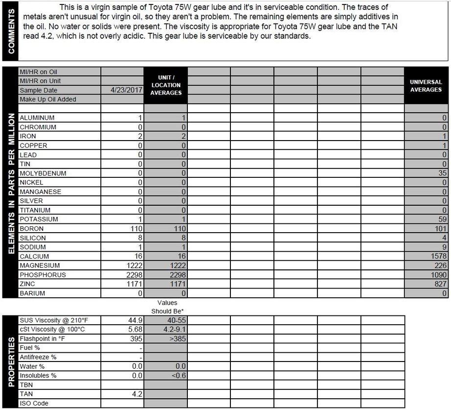

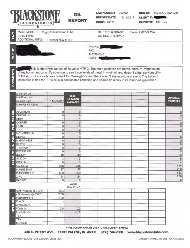

I found this oil analysis has huge amounts of additives compared to what some on here have used [mobil synthetic 75-90 wt...or revenol MT3 75WT ]

nice find. the Toyota OEM 75W certainly has a LOT more magnesium, phosphorus, zinc, and boron than the Ravenol product. i know the Toyota stuff is spendy, but considering how infrequently you have to drain/fill the t-case, it still seems like cheap insurance to me. (DIY service of the 4Runner's t-case is actually easier than an oil change, after all.)
not totally related, but i've been put off by Ravenol products and don't trust them. in the past, they've claimed compatibility with (admittedly niche) mechanical systems on the Toyota MR2 only to then backtrack on that claim as users reported catastrophic damage from using the Ravenol "equivalent". didn't happen to me personally, but it gives me pause when a company goes out of its way to claim its product is compatible with a relatively esoteric application and then causes undue and unnecessary damage after doing so.

Without wading into the issue of the appropriate location of this post, the formulation of the specified Toyota oil is not an accident. Certainly the Toyota engineers had something specific in mind. Now it may well be that the additive package is there to compensate for how "thin" the straight 75w is and that by running a thicker oil you don't need this particular additive package but regardless, the Toyota oil is formulated like that for a reason.
My personal thought is that the Ravenol product is NOT the right product for these transfer cases. It's a specific designed for manual transmissions and surely targeted to help the synchronizers do their thing. A transfer case is more like a differential than a manual transmission. I'm pretty sure that the 5th gen transfer cases are very similar to earlier units that specified 75w-90 and that they've specified the 75w for fuel economy. The logical conclusion is that the OEM 75w is formulated to be extra heavy duty to compensate for the lower specified weight.

[MENTION=115572]DesertCanyons[/MENTION]: the magnesium, phosphorus, zinc, and boron are part of the additive package...
the high values for these additives indicate that this (yes, expensive!) Toyota OE 75W gear oil has a very robust additive package — much more so than the Ravenol product. i'm sure Toyota has very good reasons for this and i don't pretend to know more than them on the subject. i'm certain, however, that Toyota knows more about this particular application than Ravenol does, and while i didn't really look at the Ravenol product in detail, as noted above while it may be the same weight as the OE spec it could be intended for an entirely different application.
re: Mobil products being "equal or better"... that's a judgment call on your part. i will say that the Toyota OE 0W20 synthetic oil is a very highly regarded product, and both my engine and t-case run the OE fluids. i do run Amsoil in my diffs, though.
EDIT: just looked more closely; obviously the MTF stands for manual trans fluid, so that would entirely disqualify using the Ravenol in your t-case. props to [MENTION=170820]MossJenks[/MENTION] above. :tea:
