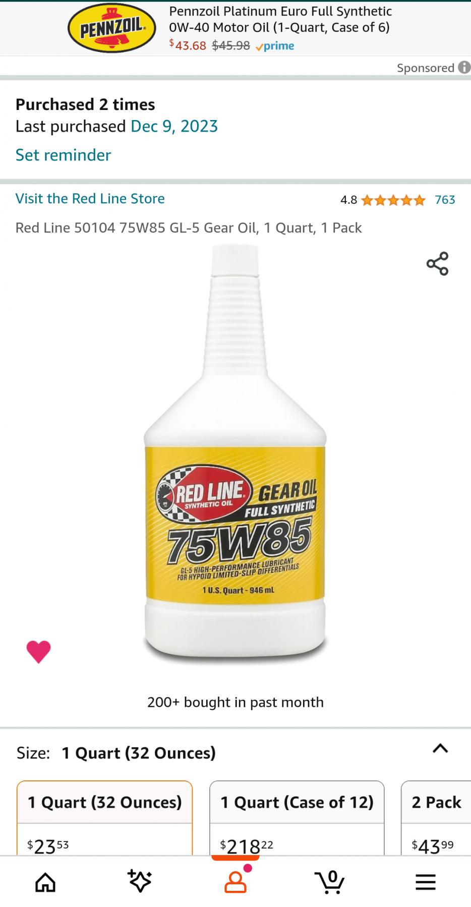

Doing my diffs and transfer case soon and just want to confirm that I can use the Redline product in the pic in all three?

Personally, I'm using Redline 75w90 in all three.
Redline makes MT-LV 70W/75W GL-4 GEAR OIL for the transfer case - which is a direct replacement fot the Toyota brand. I use all Redline products for the Differentials and Transfer case.

I used RP Max Gear 75W-90 for front and rear diffs and RP SynchroMax for the Transfer Case. So, they will probably all blow up because I didn’t use Toyota Oil.
