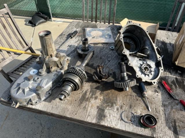

My job tomorrow is finish rebuild of NP 241C transfer case. Then pull the existing and install the rebuilt transfer case in a 1994 K2500 Suburban diesel. Total cost about $250 and a couple hours of my time.

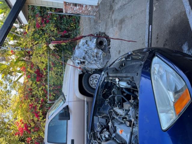

This year alone on my personal vehicles, I've completely rebuilt a NP 241 C and swapped that into a K2500 Suburban which had a leaking transfer case. My cost was $300 for parts and it was a couple hours to remove and another couple to install. The rebuild was simply replacing bearings, chain and seals. All the gears and shafts were fine. This actual rebuild took about 2 hours. Removal and install about 10 hours total, but nothing difficult.
I also pulled and replaced seals on the transfer case in our 2014 SR5. This one was even easier to pull than the one in the Suburban. Replaced output seal on transmission side and all the seals on the transfer case. This took less than an hour and the seals were about $30.
I'd like to thank those providing the cost quotes to do these jobs, which is in line with my estimates.

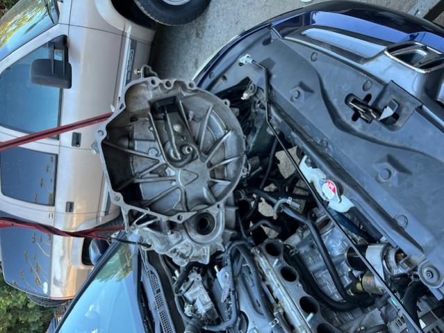

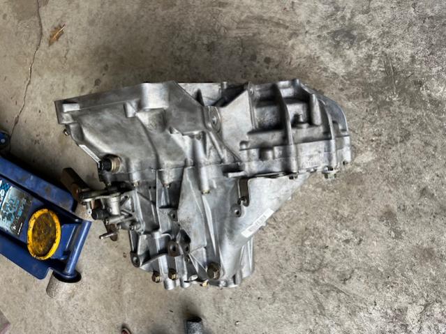

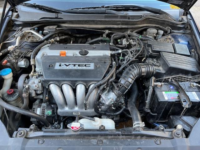

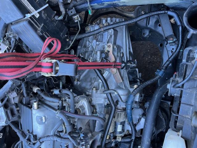

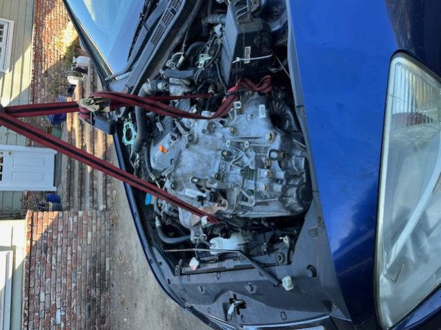

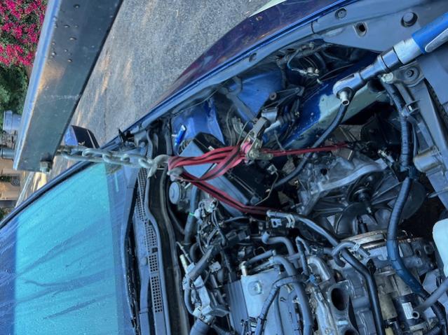

I also recently pulled and had the 5 spd manual transmission in my 2005 Honda Accord rebuilt. After replacing the clutch assembly, fly wheel and throwout bearing, it was still making a noise that would disappear when the clutch was depressed while in neutral. I knew then bearings were gone or going, which the transmission rebuild shop confirmed. I was able to pull the transmission in about 6 hours and reinstall in about the same time. Missed some football, but figured it was a $4K to $5+K job if someone else did it. Car runs and sounds like it did when new.

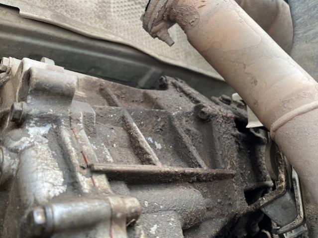

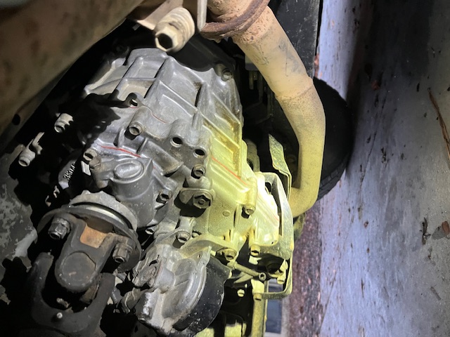

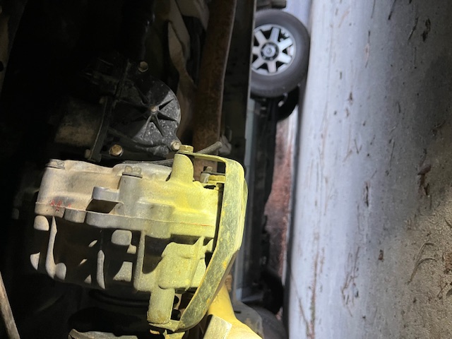

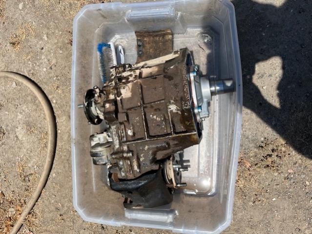

Transfer case at 343K miles, which is 7,000 miles after I repaired the leak, along with some pics of before showing the extent of the leak:
