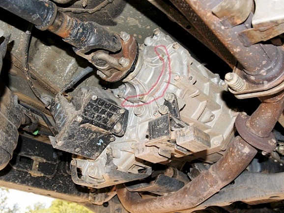

Post up a picture of what you are referring too. It makes it easier for the online mechanical speculators to diagnose.
For myself I had a leak in the area I circled in the attached picture. The job was pretty simple, took less than an hour to complete: translation not expensive.
The oil spreads all over the place, so it was hard to tell where it was leaking from. Wipe off the oil very well, and monitor it a few days very closely and watch where it starts to leak back out.

I encountered this issue as well recently. it turned out to be a warn out O ring from the T-case. It was a $3 part and called for 10hrs of labor. luckily, i purchesed an extended warenty when i bought my t4r, so the repair was covered at no charge.
