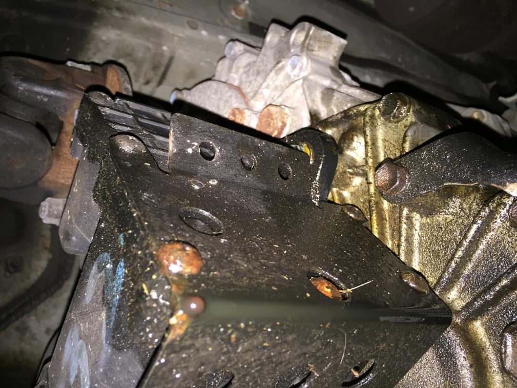

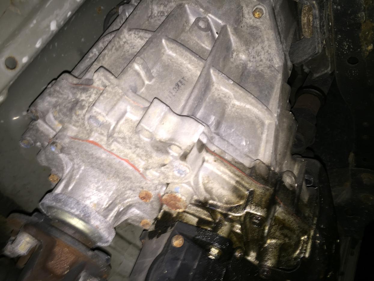

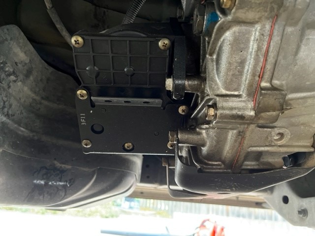

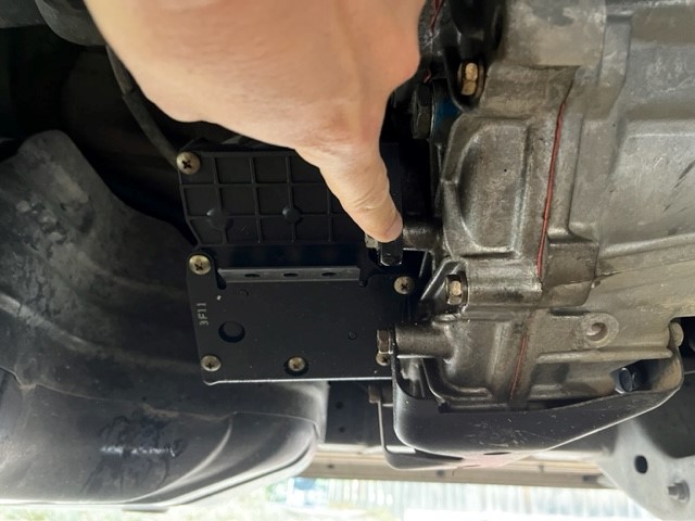

Hey guys! New here... about 4 months ago I bought a 2003 4runner with 180K on it. I saw that in had oil drips under when I was buying it but it was really nice and I got it for $4,500. So I was willing to put oil in it. Well turns out my oil never gets low so I crawled under and found it looks like a transfer case leak.
What do you guys think? Does it look like the transfer case. I'm trying to upload the pics to this post.

Actuator seal. Lots on here about it. That's exactly what mine looked like when I bought it. Dropping and splitting the transfer case in a couple months to replace the seals.

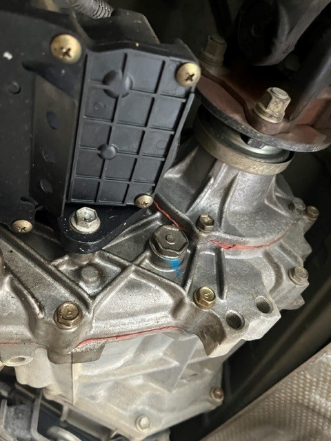

Reviving this thread to see if anyone can help identify if this is going to be a easy repair or the dreaded actuator leak.

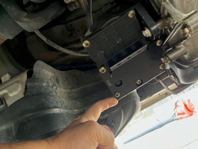

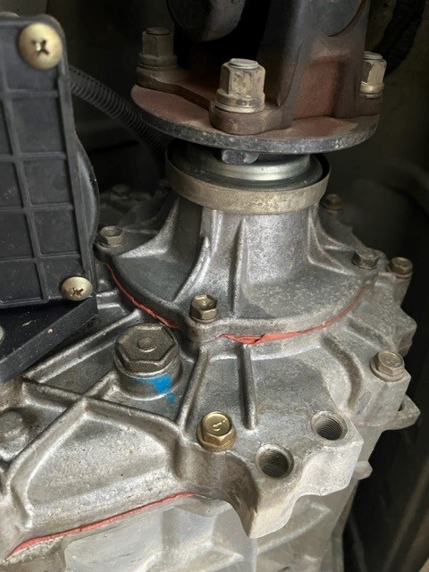

Just found a leak under my 2003 Sport V8 4x4...only 96K miles...

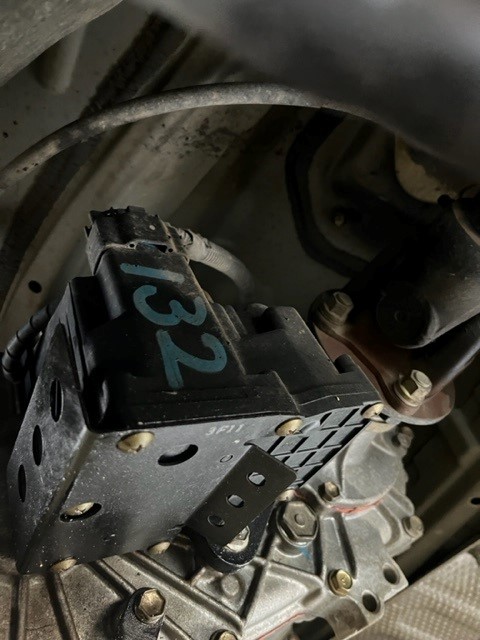

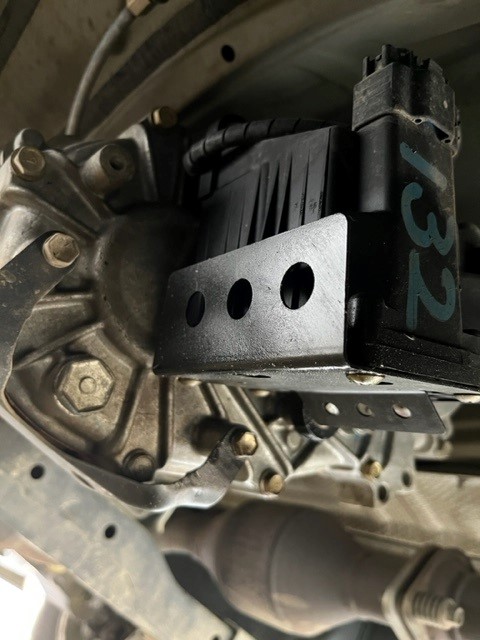

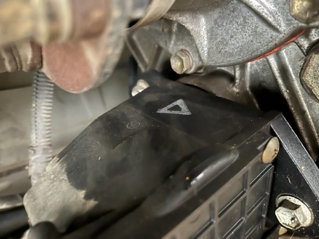

Is this the actuator leak? I have a half-dollar size spot on the driveway from about 2-weeks of siting and I suppose leaking.
