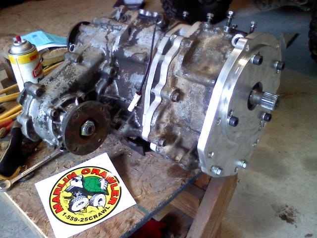

top shift reduction box mated to top shift transfer case with auto transmission adapter

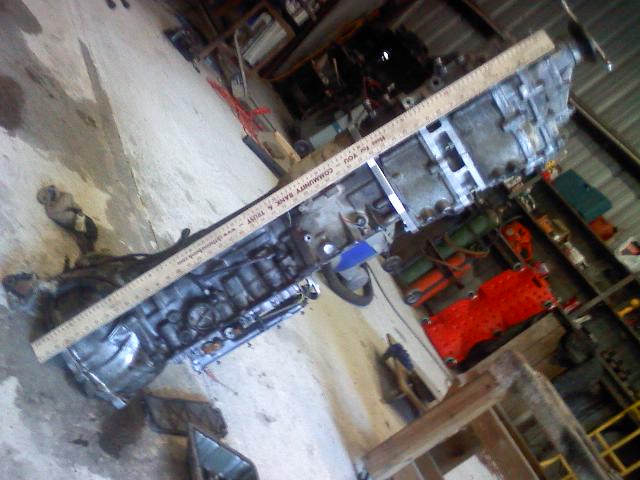

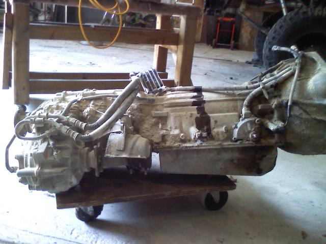

mated to stock transmisson. ITS OVER 4 FEET LONG!!! I think my front drive shaft will be longer then my rear drive shaft! I cant wait!

Yeah. I have a massive transmission jack for big rig trannys. Its actually pretty light compared to what I usually work on.
Yeah, a BF Tranny jack would help. That would be too much for your typical tranny jack.

You know, that auto transmission adapter was $500 bucks and I didnt even get a darn sticker???
