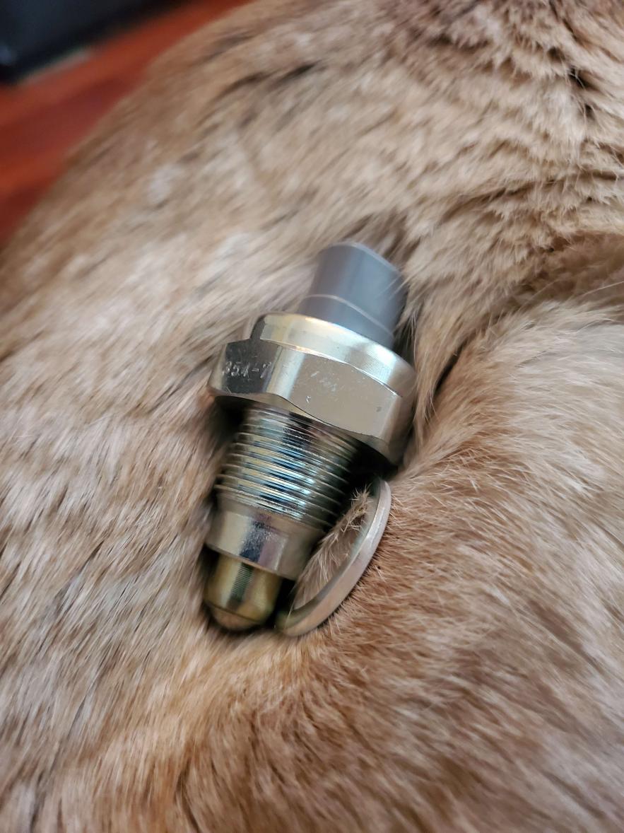

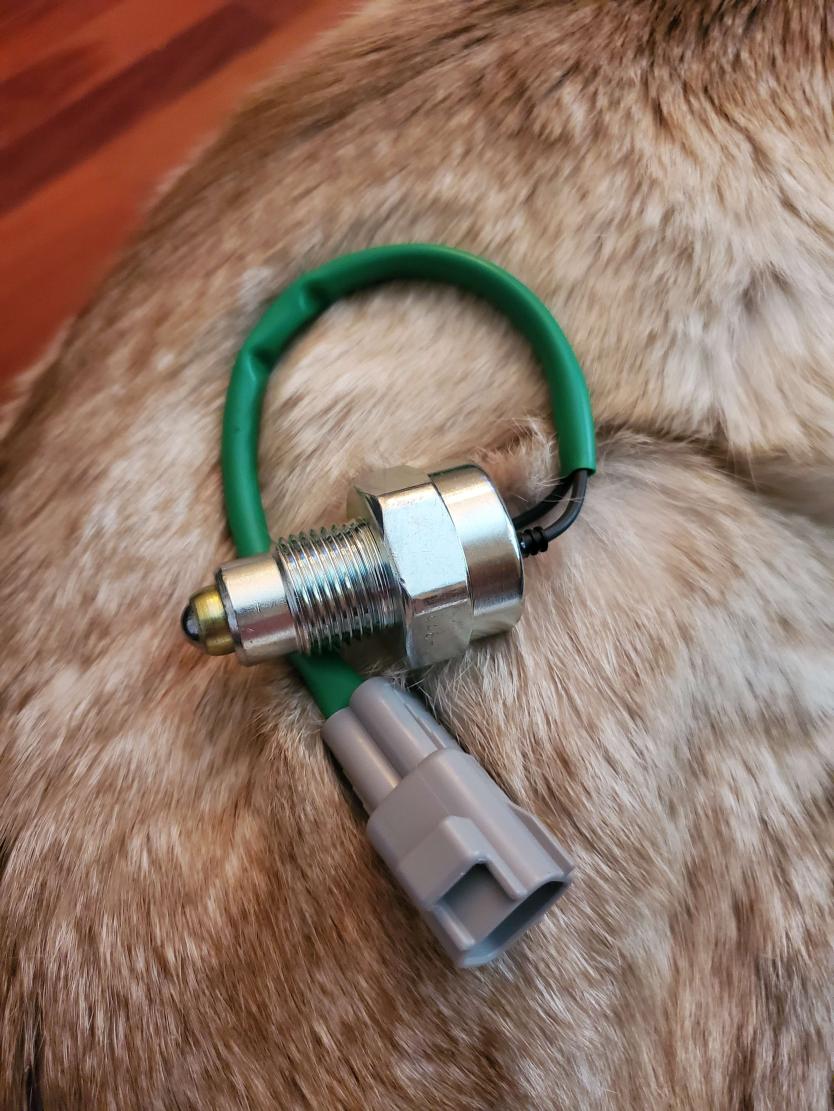

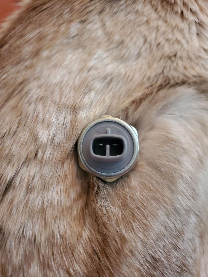

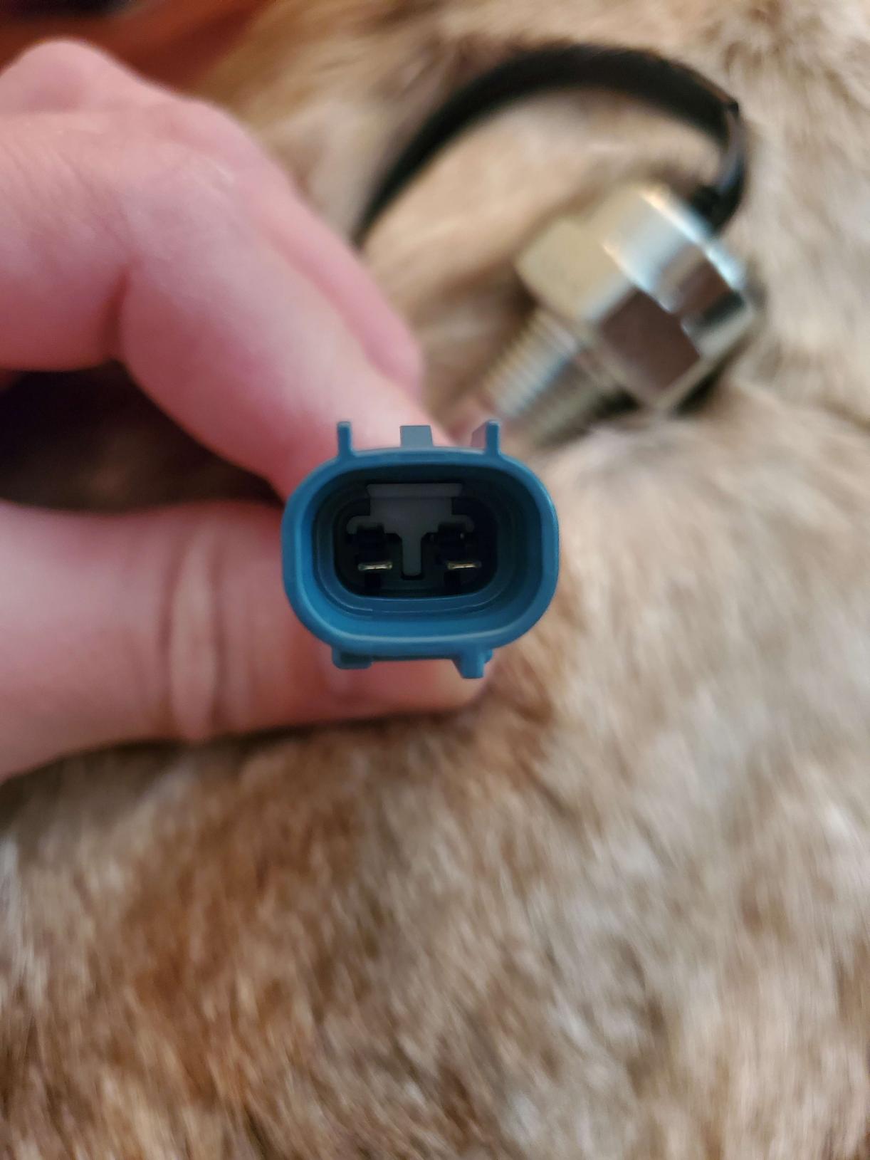

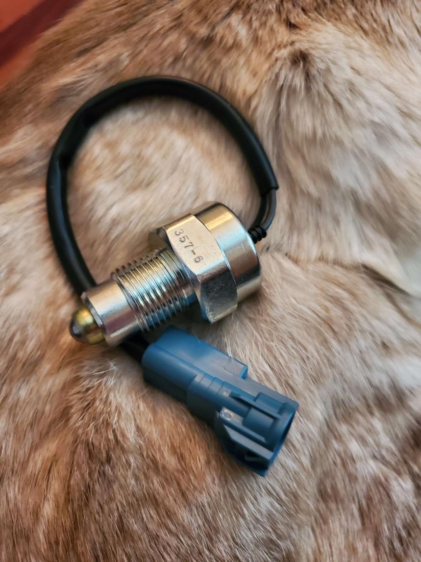

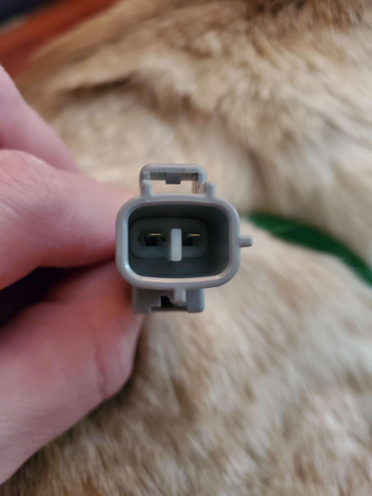

No it is not. The add actuator switch has the connector on the switch, while the other 3 switches have a pigtail and different connector keyways. See pics. Also these are the part #'s I ordered for my application, 2000 4runner sr5 v6 auto. I also found the diff lock and ADD switch are the same but the diff lock switch is cheaper for some reason.
1st pic switch w/gray connector: 8422-12010
2nd pic switch w/pigtail gray connector: 84222-35090
3rd pic switch w/blue connector: 84222-35080 (2 of these needed)
