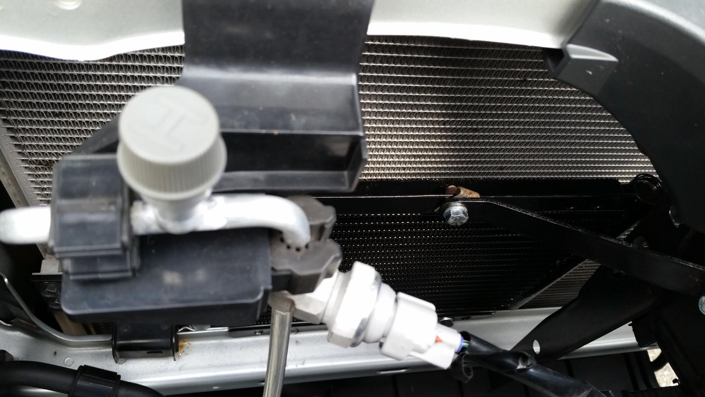

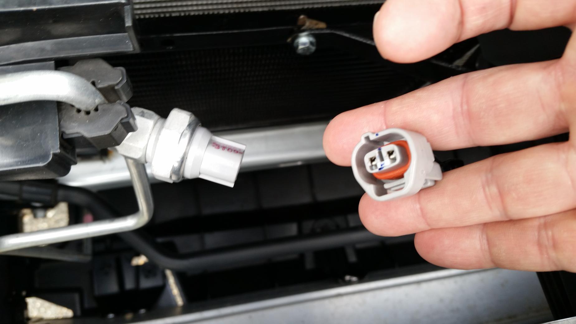

WanderMT was right, either they forgot to plug in this connection or it came lose.
This is a wire just in front of the radiator, plugged in back in and nice cold air started blowing. Took longer to take off the cowl.
