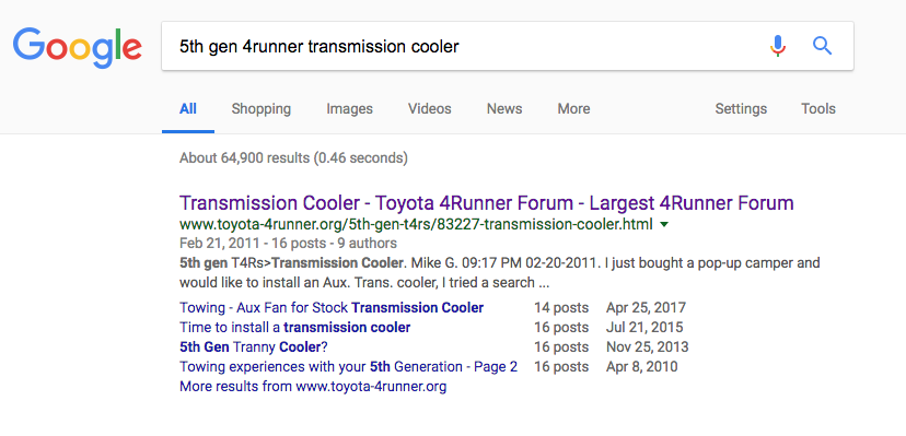

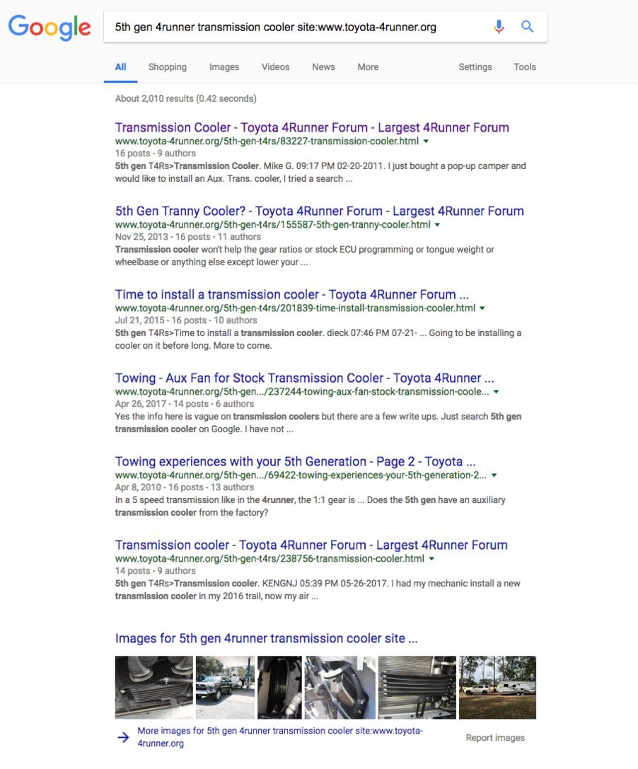

I agree with [MENTION=118321]Jetboy[/MENTION], but at the same time I have to explain this kinda stuff to my parents/grandparents all the time with screenshots.
Here you go OP
