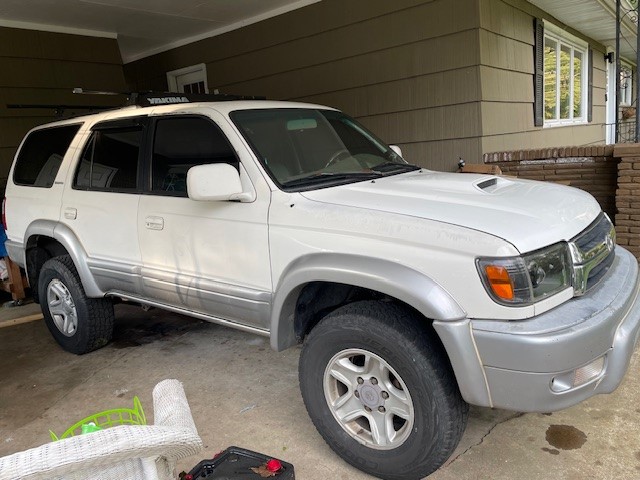

I've had my external B&M 70264 transmission cooler for probably 12 years now, got it when they were all the rage back in the day. Over the past year or so I've been noticing small drips of ATF on ground. Replaced my radiator a few months ago and replaced all the hoses and clamps for the transmission cooler lines, thinking maybe a hose had split or cracked somewhere. Last night while idling my truck for a while in the driveway, it dumped a pretty good puddle of ATF. Definitely coming from the cooler, but I think on the back side of the cooler that's pressed up against the a/c condenser. Doesn't appear to be coming from the hose connections from what I could tell.
Anyone else had one of these fail? Probably going to replace it with something bigger, maybe a Hayden 699 since I do a fair amount of towing my boat.

My guess is maybe one of the tubes developed a crack that's slowly getting larger. It's definitely coming from the cooler somewhere. Ordered a Hayden 699 as a replacement. Hopefully I'll have time to swap it out next week, I'll post pictures of anything I find.

Replaced my old B&M with a Hayden 699. And magically the leaking ATF problem went away. Old cooler had a ton of gunk on the side facing the condenser, presumably all the crap the fluid attracted and built up over time.
