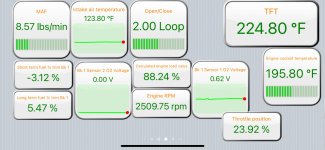

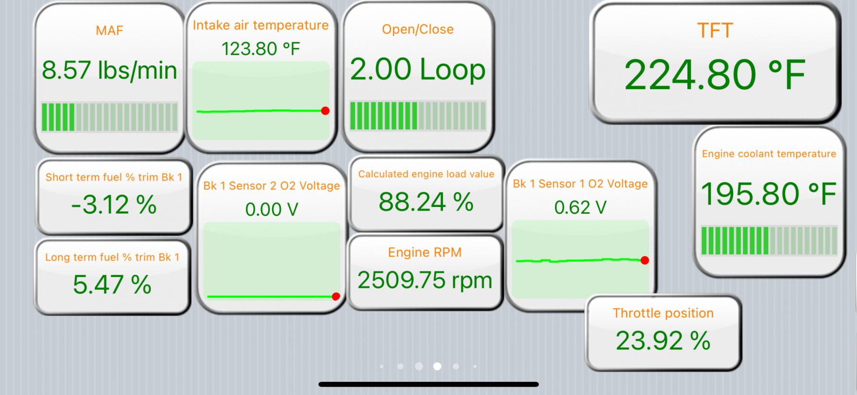

About 225 degrees was the hottest it got after pulling the boat to the top of the mountain today. Hayden 699 in series after the radiator transmission cooler.
