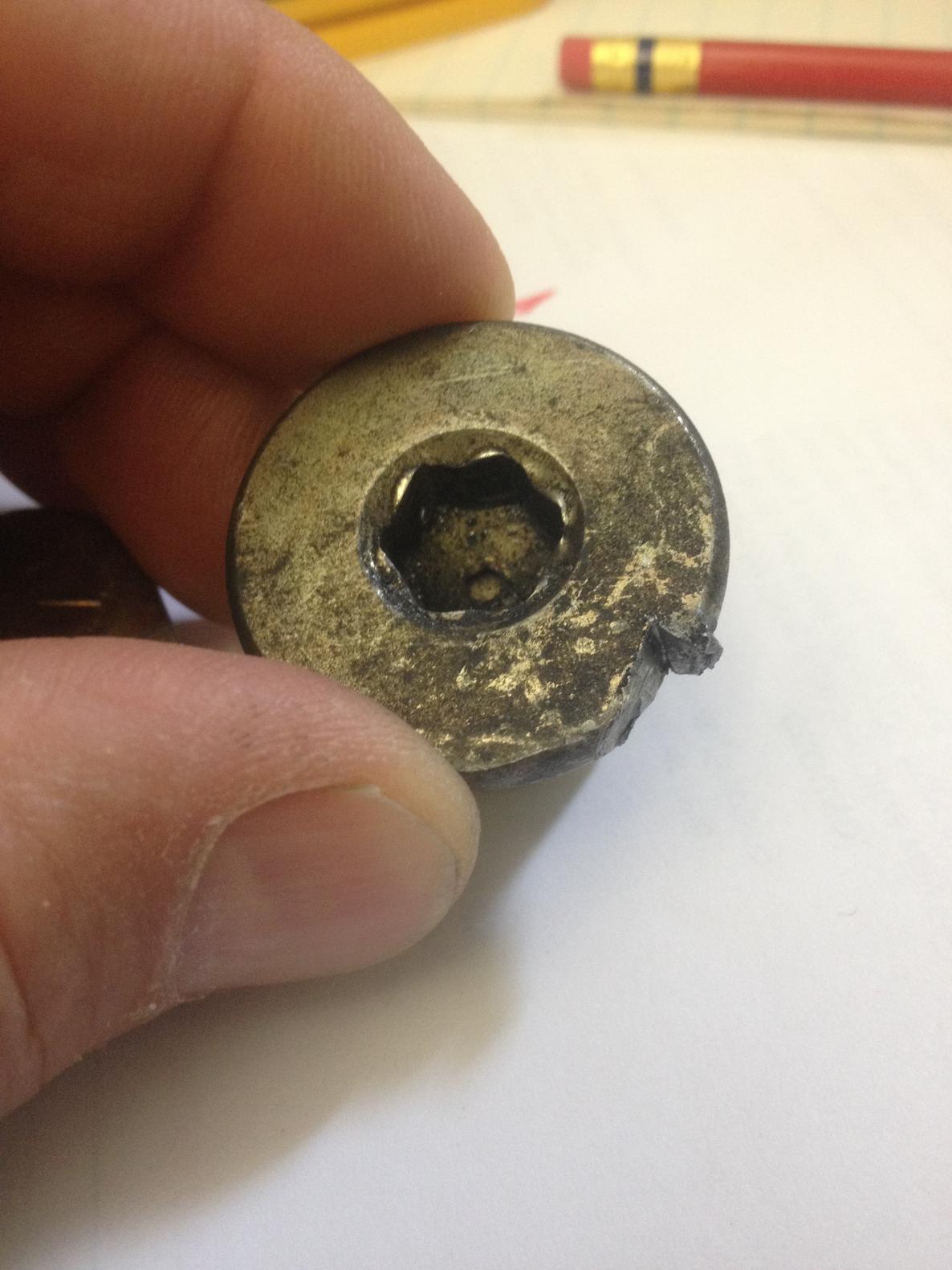

Use a cold chisel to make a cut like this, In the direction to remove the plug. Then use a punch and hammer and tap it loose.
I like it! I usually go at it with a prick punch near the edge like that. Once I've got a hole started, I angle the punch to rotate the fastener. Anything that heats or vibrates the fastener will help free it, sometimes just whacking it with a hammer helps.
Another option is to grind a slot in it with a dremel, then turn it with a drag-link (straight-slot attachment for socket wrench).
