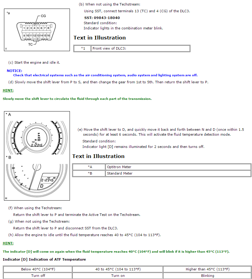

This is the best how-to I've found and how I did it on my GX. Temp needs to be between 115-130F. I had access to a Snap-On Scanner than showed actual trans temp, and as I was finishing, fluid would continue coming out as the fluid was warming up and expanding. It is definitely tricky and I think the margin of error is only half a quartish.

This is the transmission temp check procedure from pdf above:
5. FLUID TEMPERATURE CHECK
NOTICE:
The fluid temperature should be less than 30C (86F) before
beginning the fluid temperature check.
(a) With hand−held tester
(1) Connect the hand−held tester to the DLC3.
(2) Select the tester menus: OBD/MOBD, ENGINE,
DATA LIST and A/T.
(3) Check A/T OIL TEMP.
(4) Allow the engine to idle until the fluid temperature
reaches 46C (115F).
(b) Without hand−held tester (Using A/T OIL TEMP indicator)
(1) Connect terminals between CG (4) and TC (13) of
the DLC3 using SST (09843−18040).
(2) Move the shift lever back and forth between N and
D every 1.5 seconds for six seconds.
(3) The D shift indicator on the combination meter
comes on for two seconds. This indicates that the
fluid temperature check mode has been started.
(4) The D shift indicator will come on again when the
fluid temperature reaches 46C (115F) and will
blink when it exceeds 56C (130F).
(5) Allow the engine to idle until the fluid temperature
reaches 46C (115F).
Keep in mind that the levels will vary based on temperature so top up accordingly.

At this point you should have approximately the correct amount of fluid in the AT and everything is reconnected. It's time to perform the fluid level check to ensure that the right amount of fluid is in the transmission. I will briefly go over this as a great write up has already been done by ForTech (http://www.tacomaworld.com/forum/2nd-gen-tacomas/63851-how-drain-refill-automatic-transmission.html ). Do NOT use an IR thermometer - the pan reading won't be anywhere close to the internal temperature.
Cliffs notes version, but I highly suggest reading ForTech's post:
Make sure you're parked on level ground,
Start truck, shift through all gears several times to get new fluid moved all around.
Using a small wire, jump pins 4 and 13 on the ODBII port.
Start the truck, you should see a lot of your dash lights flashing.
From park, put truck in neutral for 2-3 seconds
Shift down to drive for ~1 second, enough for it to barely engage the gear then go back to neutral then back to drive after ~1 second. (repeat 3 times, total of 6 shifts).
Once back in neutral after 6th shift, you should see AT Temp in red light up for 2 seconds on the Tach face plate.
Shift back to park, you should see the AT temp light again for 2 seconds then go off. If you don't see this, you've messed up and need to do it again.
Let the truck idle until the AT temp light stays on. It's close when it starts flickering. It may take up to 20 minutes of idling to get to temp, especially in colder environments.
Step 11: With the AT Temp light on and the truck still idling, remove the check plug(5mm hex). Be mindful of the Y-pipe / exhaust as it's hot and you will burn yourself if more than lightly touched. Also have your catch bucket ready. Hopefully you've added a little more than what's needed and fluid will come out. Allow fluid to drain until it's a light/thin trickle. Add your new crush washer to the bolt and replace the bolt torquing to spec (15 ft.*lb). Turn the engine the off."
