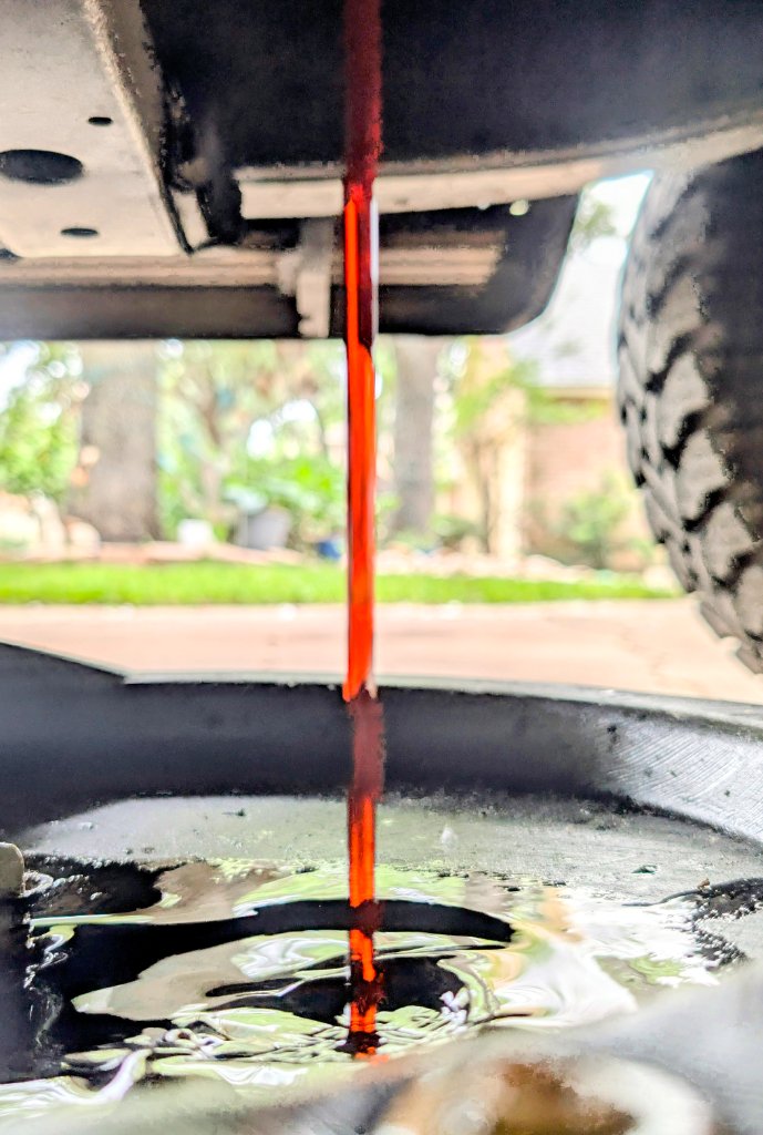

This update is at 22K since its life began Dec 2022. The trans has operated flawlessly since yet I decided to do a D-F using Maxlife. The original fluid was Toyota TIII (non-synthetic). I let it drain for a couple hours and when I returned it was still dripping about 1 drop every 2 seconds or so. I measured what came out - right at 6 qts. I run a 699 haydon and temps never exceed 190 (stop-go) while normal driving yields 170.
The bolt magnet had Zero on it and I am thinking based on attached pic the fluid was not near needing replacement. May go 30K next time

In regards to the frequency at which to perform drain and refills, I do them every other engine oil change, which is around every 10k miles. I don't let mine drain over night like you did so I usually exchange around 4.5 quarts. I replace my Magnefine inline filter every 20k miles. It might seem like overkill, but ATF isn't that expensive and cheap insurance to give your auto trans longevity. I drive in the mountains a fair amount, so my transmission is reaching higher temps than the person who uses their rig as a grocery-getter. The higher the temps, the lower the effective life of the fluid.
Have about 15K on mine I had done in December 23', getting ready to do a flush soon, less out of necessity more out of curiosity. Have had zero issues and hundreds of miles of off roading in the high temp dusty desert. The dudes at Yota1 were awesome the entire time. I'm in southern california but my dad lives about 15min from Yota1. Whenever I'm up there I try and have something lined up for them to do for me. Great shop, most knowledgeable folks around
