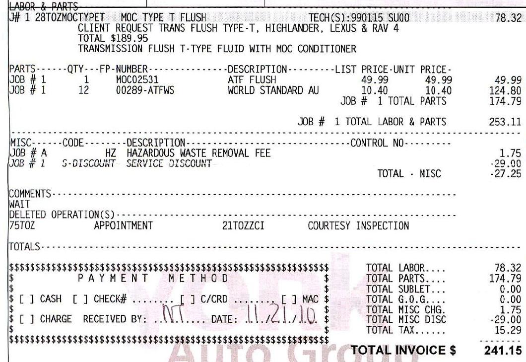

Seems reasonable to me, I paid $241 out the door for mine.
