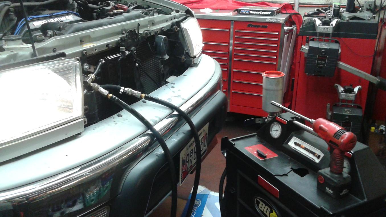

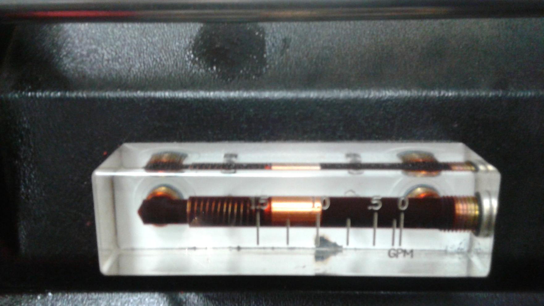

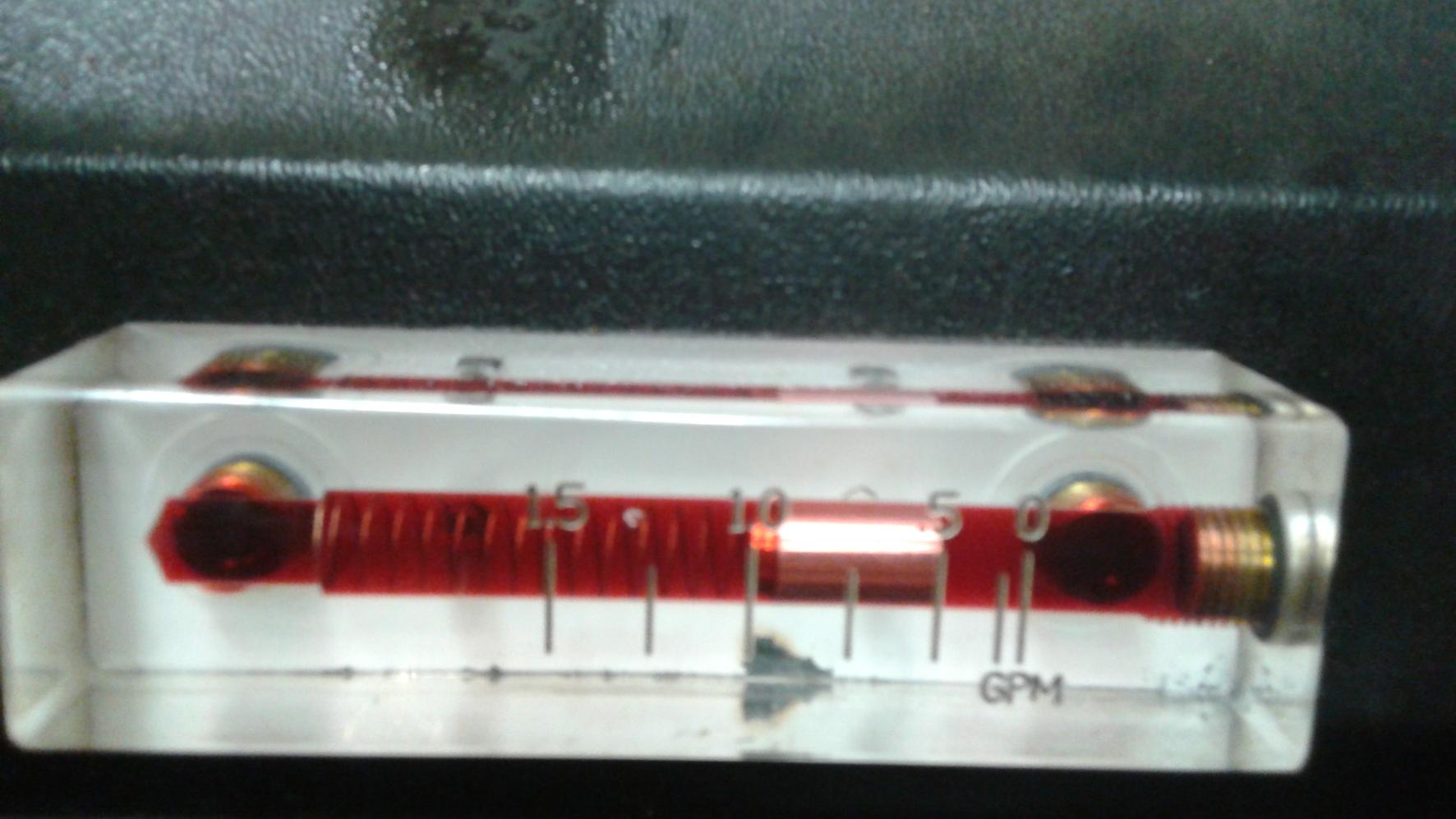

On all my vehicles i use a BG trans fluid exchange machine, no matter the vehicle's mileage. What i like about the BG machine is it works off of the transmissions own pressure, the new fluid simply pushes out the old fluid by means of trans pressure. Another plus is this machine only puts in the amount of fluid that it takes out. It's not a high pressure flush like most machines which can result in trans issues shortly after. No excessive added pressure to disrupt any internal trans components. Just recently added a external cooler and performed this flush to my 02 runner. The machine shows the difference from the old fluid to the new fluid, see pics.

Just to be clear the BG machine is not a flush machine, it is an exchange machine and uses the transmissions own pump pressure to move the old fluid out and "exchange" with new fluid. There is no way it can move debris to places that the tranny pump itself wouldn't move around. The T-Tech unit is another style that uses the vehicles pump pressure. Now there other types of machines that use pumps to exchange the fluid (Motorvac, Snap On - Made by Fluid Dynamics) which, in my opinion, should also be OK, but if not operating correctly, can overfill/underfill and cause problems. There's also several machines that exchange through the dipstick electronically using the same procedure that some have used on here to exchange fluid by emptying the pan refilling , starting vehicle and running for a small timeframe then repeating the process. Also, many shops use flushing chemicals and additives which really should not be used in high mileage machines.
