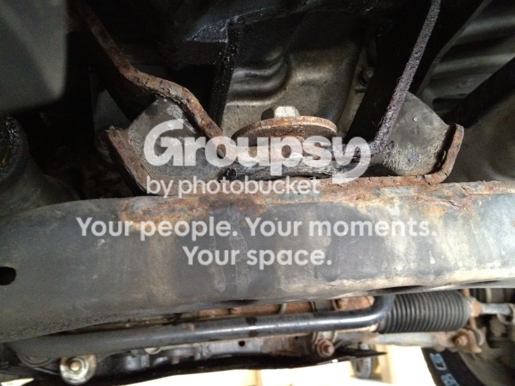

To make a long story short, I'm trying to solve a vibration in my newly purchased 4Runner. A new rear U-joint and drive shaft balance took care of most of it, but there is still some drive line roughness. Could this mount be causing the rest of the vibration? To me it looks shot...

Um.
Yeah.
That'll do it.
Obviously there is going to be some vibration, but that's what the mount is there for. It's designed to soften that up.
Get a new mount and see how it does.
If that doesn't help, check your cross member bolts and cross members, then your engine mounts.
Yes, that mount is bad.
What are the specs on your runner? I think I have a NIB mount just like that from a misorder. If I can find it, Ill send it on its way.

Will do, thanks.
It's a '99 SR5 V6 4x4 5-speed. The mount is specific to manual transmissions (part # 12371-62110). Will send you a PM.
