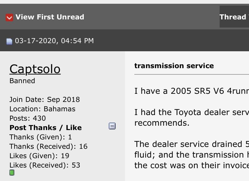

Well I’ll be a monkeys backside. Are you back again? Why dont you let your mechanic with 5 bays do it for you?

What happened? what did he say? LOL. Being a moderator at another board, I've banned folks for being belligerent, spam, dubious links, etc etc.
Anyway, my opinion stands, Captn should do another drain/fill. These aisin transmissions have a history of lasting, well, forever. Doesn't hurt to get fresh ATF in there if you love your rig (and want it to last long).
oh this original thread is almost 2 year old lol. someone just commented on it, which brought it back to the top. The captn has been banned for a while now
Haven't been on for awhile and clicked on this thread before I saw who the OP was. Then I noticed he was banned. Can't say I'm surprised. But how are we going to know how many starters he's replaced now and where will will find some decent pics of a fishing boat? :naughty:
