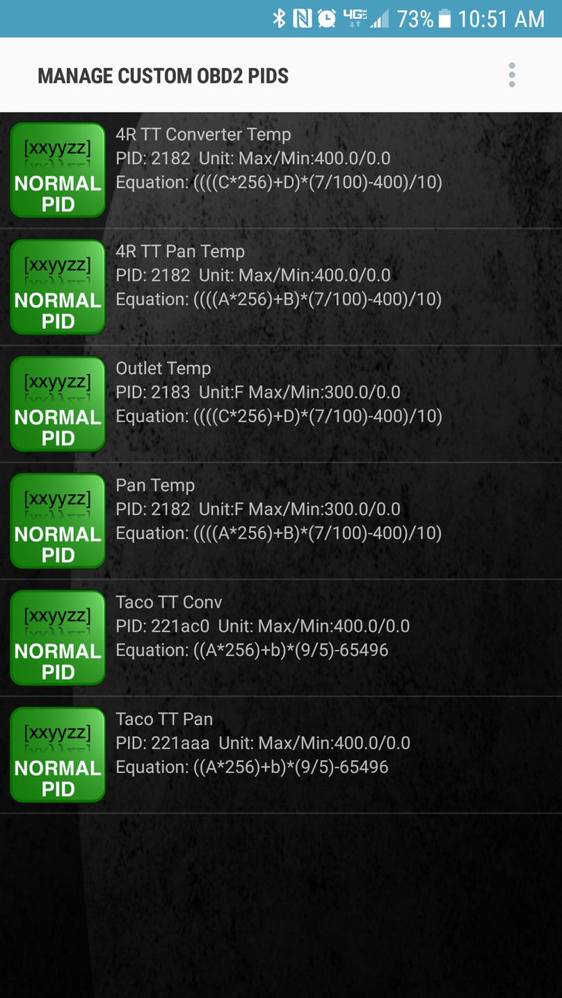

The PIDs are out there, i'll find them and post them in a bit. I used them on the torque app and they worked fine.
I use the obd fusion app as well. You can pay to have all of the PIDs in there. It also works well. Although it says it has an engine oil temp measurement, it really doesn't.
Here are the torque settings for the 4runner. Ignore the Tacoma as it is invalid.

Sorry to bump such an old thread
I figured it out and wanted to let everyone know.
Torque lite does not allow custom pid from what I can tell.
Torque pro does and it worked like a charm with the settings mentioned in countless other threads
