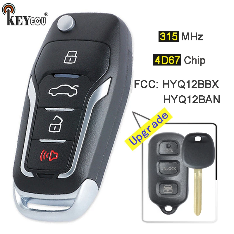

Here is the fob that I purchased off AliExpress, around $27, got the blade cut at a local locksmith for a few bucks, and programmed the remote myself. Totally DIY-able.
Key points when purchasing aftermarket keys is ensuring that the FCC ID and the mhz are the proper ranges. Most key remote listing will show the applicable cars anyhow, but make sure they match!
KEYECU-314MHz-4D67-Chip-HYQ12BBX-HYQ12BAN-Upgraded-Flip-3-1-4-Button-Remote-Key-Fob-for.jpg_Q90.jpg_.webp

I bought an OEM key and had dealer cut according to the Toyota computer record for my VIN. I then used this pristine copy on two cheapo ebay keys. I did all programming myself. Ebay remotes are not so great, the panic button is not recessed enough so get too many inadvertent alarm activations.
